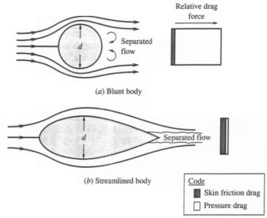

Here’s a pic depicting what happens when the trailing edge starts to fall off rapidly , like a sphere ... sorta’ ... AND we may NOT want to make them Smooth ... :o http://www.aerospaceweb.org/question/ae ... 0215.shtml

Postby loaderman » Mon Feb 27, 2012 10:15 am
INteresting thanks GPW.
Notice the #27 cupped hand shape is the worste for aerodynamics, as one would expect.
Read the full article and links. :thinking:

L’ , boxy trailer’s Not much better eh ?? ... Looks like the clear winner is #2 with the squared off back ... :thumbsup:
