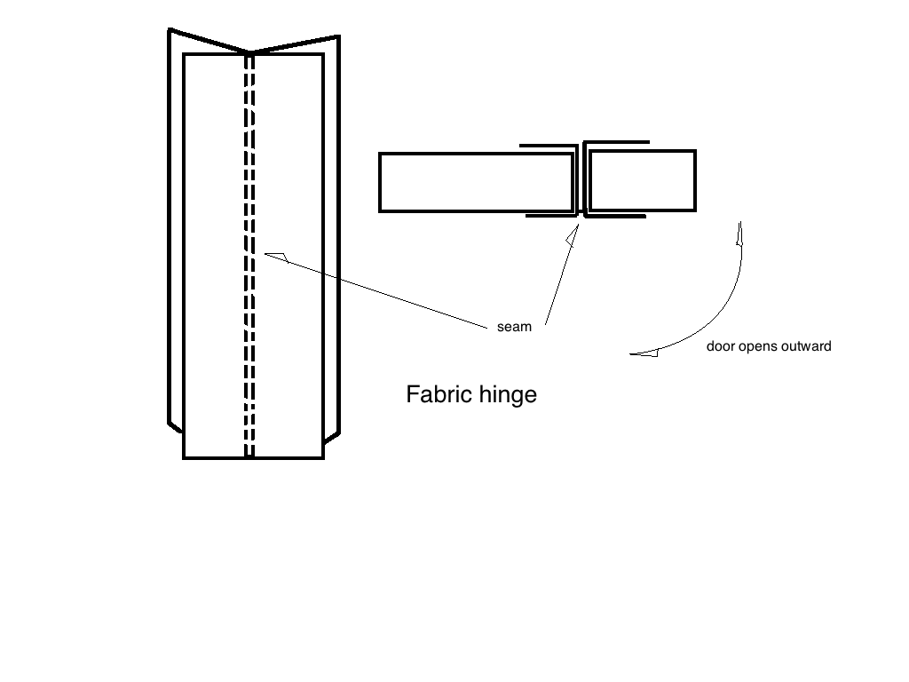

Wood , maybe not , the skinned foam is pretty strong ... Now you got me thinking about a fabric hinge ... easy enough to sew together two long strips of heavy canvas down the middle with a heavy poly thread, glue it up and that seam becomes the hinges ... Perhaps another drawing is in order.. :D

I couldn’t help but do a drawing ... :D
fabric hinge .png (15.25 KiB) Viewed 761 times
