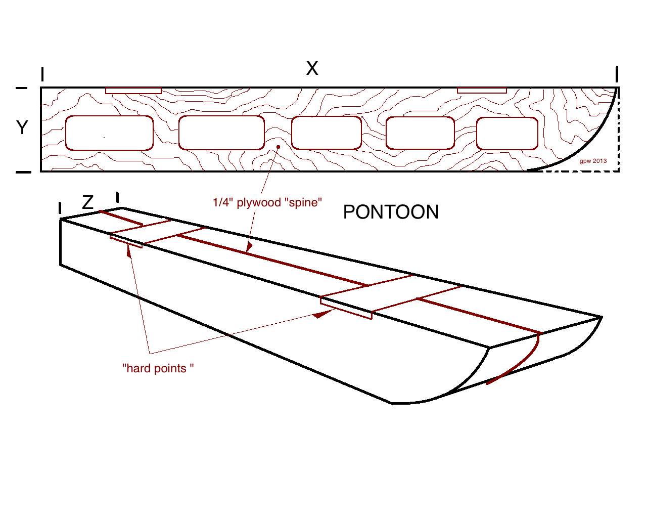

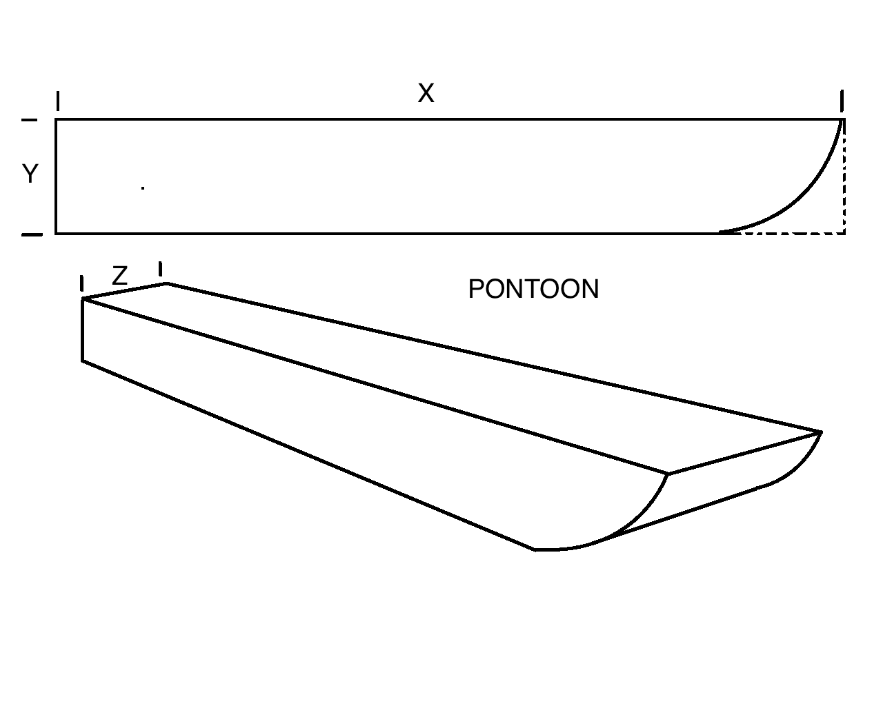

Postby GPW » Fri Jan 25, 2013 9:06 am
Here’s a simple Pontoon ... you need TWO !!! (schmaybe’ Three ? ) Big blocks of foam are available ... make the pontoon the size of the blocks you find , or just glue more foam on .. A “spine" may be nice if you’re gluing up smaller blocks ... and naturally some “hard points" will be needed for attaching everything together ... I’m sure there are many and varying opinions on all that ... :roll:
For more durability (and Cool looks ) , you “could” cover the foam with a fabric and paint it :thinking:

Postby GPW » Fri Jan 25, 2013 12:16 pm
Pontoon with wooden spine and attachment "hard points” .... Just an idea ... crumbs for thought /discussion ..
