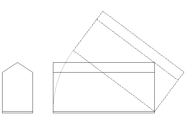

OK…Now you all really screwed me up. I surfed this site looking at teardrops and found a canned ham I am going to restore but I was torn because I had my heart set on a Teardrop but cost too mush to do both. Now I see foamies…Now all I want to do is build one! For an experiment I want to use the process to build a motorcycle storage shed to test some concepts. I lost custody of the big house with the big garage in the divorce and the house I bought does not have a garage so my motorcycle is just under a cover. I was thinking a foam building say 4.5 X 10. Wood Ledger on the bottom so I can rebar it to the ground yet can move it. Semi a-frame design with a 2X2 stick frame on the edges and the door. Have any of you built something like this? I am in Virginia and humidity on a bike under cover is rough so I have some rust starting. I plan repainting it soon but thought this might get me buy me some time for a while. I could install solar powered fan to keep the air flowing over the bike on high humidity days. Guess I will be knee deep in sketchup this weekend and I blame you all!.…..Rick

Manoeuvring a bike into and out of a regular shed can be a real pain. So how about building a foamie 'hat' for your bike hinged to a base plate. To get the bike in and out, just hinge the whole hat/cover up out of the way with a couple of light props to hold it up - maybe even gas struts.

As I was sitting in a long death by powerpoint meeting I had the same thought. I was thinking bulding on a platform with skids I can move it close to the house when I am riding allot and in the back during the winter. Use minimal wood other than a sole plate, maybe roof support, and places for like you said gas struts.

If you do the clamshell design, I would concider building up a foam berm around the hinge end and both sides just to the inside of the top shell. If the seal at the bottom of the walls doesn't seal 100/ct this will prevent water from coming all the way in and running over the floor. If you set the base on a raised gravel pad with a downward pitch toward the door end, you shouldn't get much water running under the door sill end (since you wouldn't want a berm at that end).
