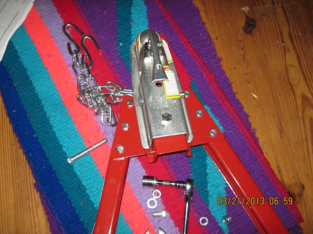

104217 Assemble the toold you need to get the trailer together. :thinking:
104218 The parts are on the floor and all accounted for!!! :)
104222 Assembly begins in earnest
I must admit I have a few pinched fingers. :cry:
104223 It is coming together

The HF trailer comes with a goo in the hubs and bearings and need to be cleaned off and the bearings repacked. It sounded a lot harder than it was but after reviewing the info on repacking it was easy. The hardest part was removing the back bearing. With a little help (a stronger person than me) it was accomplished. now take a look at the following picture of the black specs in the cup of paint thinner that is the little pieces that were washed out of the bearings before packing with grease.
before: 106798
The cup with the pieces of metal residue: 106797
Re-greased: 106799
I did put more grease in just before putting on the cap, I filled it full
106803
just some more pictures putting the frame together:106800
106801
106805 with tow vehicle
106808 a little wiring
106806 I put the nuts on top so a big bump wont shred my tire.
106807 This shows why I need a raised ball on my tow hitch
I have a few more to bring up to date but it will have to wait till tomorrow.
