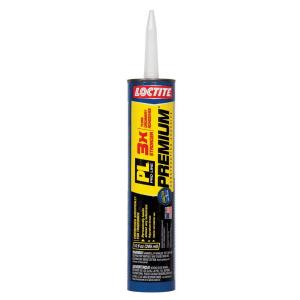

I used this on my poly mix treated plywood
http://www.homedepot.com/p/Loctite-PL-Premium-10-fl-oz-Polyurethane-Construction-Adhesive-1390595/202020473#.UbP58lko61s

WOI, that looks like some good stuff ? :thinking:
