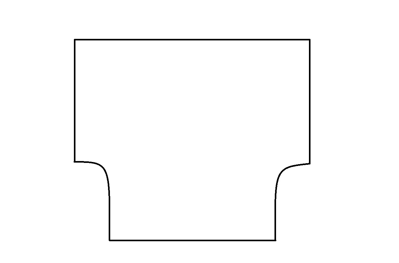

Hey folks ~ I'm pretty much decided on building a foamie, but one of the key design elements is a queen sized bed (I'm 6'4" and 250lbs, to sleep comfortably I need the length of a queen bed and to be nice to my wife, the width is essential too). But when you consider 2" foam ~ that I'm not even sure I can get here in central GA for a price I'm willing to spend ~ added to the 60" of bed width and 1.5~2" for wheel spacing, we're hitting ~5'8" wide unless one builds the floor over the wheels. I don't really want to do that as it looks awkward to my eyes (too much space under the floor, same with too Tall of a trailer when the car roof is only 68"). With a low TV (my 2001 Jetta TDI):
I'm not needing any more than the same 4" of ground clearance that the car has... But the queen bed and a foamie means I can't just use a 5' wide trailer with ease (at least by my math). I'm not too keen on going to a 6' wide because A) they're more expensive and B) I'd rather not have a trailer that's wider than the car (which is 68") to keep my wife comfortable driving with the trailer.
To add to the mix, this old boat trailer is for sale near me for $150... seems the perfect platform (assuming it's not all rusted out, I've not inspected it yet), but it's only a 5' wide trailer.
I've seen other trailers with a modified queen bed where the wheel wells cut into the interior space from about the knees down and I'm slightly considering that approach. Are there other options I don't know about? I'm sure there are, since I've only read maybe 0.000001% of the info here, just trying to justify the trailer purchase before someone else snaps it up.
Otherwise I've seen a 5.5' wide trailer (6 hours drive away :thumbdown: ), and wouldn't have any issues in scalloping the foam a little behind the wheels to gain clearance. More money, but for the oddity of the trailer it's not too bad (and it's still cheaper than a NT/HF unit), though no suspension.

TPCE is 64 inches wide (outside of frame rails and outside of walls) with 1.5 thk foam and 5mm inner skins leaving 60 inches for the std. queen size mattress plus about 5/8 for "tucking". (Actually, the door seal frame, toe boards and surface mount wiring chases encroach on this a bit more, but I figure it is foam and I can either squeeze it or trim it a bit.)
Now, I did build a custom frame and had to use more sheets of ply to accommodate this, so I wouldn't necessarily recommend it. Most people make their max dimension 60 inches (usually the roofing) and work their way back from there. Foam mattresses cut easily, or can be ordered to specific dimensions.
The "no suspension" is a non-starter. Don't even think about going there. In fact, I would hazard to speculate that most states do not allow it (...or maybe it is based on weight?).
That boat trailer looks like a decent start for a reasonable price. Maybe start by offering lower, depending on whether the rust is heavy or just surface.
Please think again about how your car, with it's 4 inches of ground clearance, traverses an obstacle with it's 2 "axles" located pretty far out at each end, vs. the trailer which only has one axle located well away from the fulcrum point (the rear "axle" of the car). The trailer is a teeter totter, the car is not.
I'm building for moderate off road use, so am not an expert, but from what I have gathered most road TD's like about 8 to 10 inches of frame clearance (anyone please check me on this).
Hope you find some or all of this helpful input. Looking forward to following along with your design and build progress. :thumbsup:

Point taken about the trailer clearance. I'm not shy about dirt roads (born and raised in Wyoming, dirt roads are where the good stuff is found 8) ), know how to position my Car wheels to deal with roads that are rutted badly, and certainly don't bomb down any roads, anywhere. The TD would certainly be taken down rougher roads though... like this (leading into Dinosaur NP in NE CO):
But I'll leave this type of stuff to my motorcycle trips:
I think I'm going to go ahead and buy (pending inspection) that top 5' wide trailer and deal with it. After all, this is a first build, not the only/last/forever (though it could be ~ depends on my skills). The only reason I was looking at 2" foam was because that's what was used in the Big Thread (yes, I read it.. skimmed through the chit-chat though after about page 120~130), I had already decided to go with FG for the outer coating because the wife wants "pretty", and her brother is in auto painting/restoration so I've got a bodywork guy on hand. I'll just make the bed tapered in at the wheel wells, like this (and this is NOT to scale, I'm not good with drawing anything, much less on the computer):

Cut-outs for the wheel wells, starting about the knees
Bed layout.jpg (30.74 KiB) Viewed 2280 times

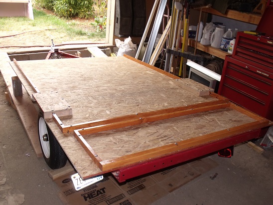

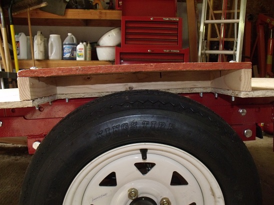

My build is around a queen size bed, well 2" shorter which would make it a UK queen size bed :D . I had to make a decision on making the rear storage smaller or the bed. To get a standard sized cooler in the rear I chose to shorten the bed a bit. I could have made the trailer longer, but I wanted to make the sides with a single sheet of foam for simplicity. I have mine on a Harbor Freight trailer with the 12" wheels. With the 12" wheels I had to make wheel wells in the sleeping area. They are pretty short and when laying in the trailer it seems that they should not intrude into the normal sleeping area of the bed. If they do cause a problem I will simply raise the height of the floor by making a spacer with foam and light ply. Maybe even put in some under bed storage. I could have gone with the Harbor Freight trailer with the 8" wheels and probably would have been fine with no wheel well.
Floor
DSCF2189 small.jpg (136.82 KiB) Viewed 2212 times
Wheel
DSCF2186 small.jpg (115.67 KiB) Viewed 2212 times

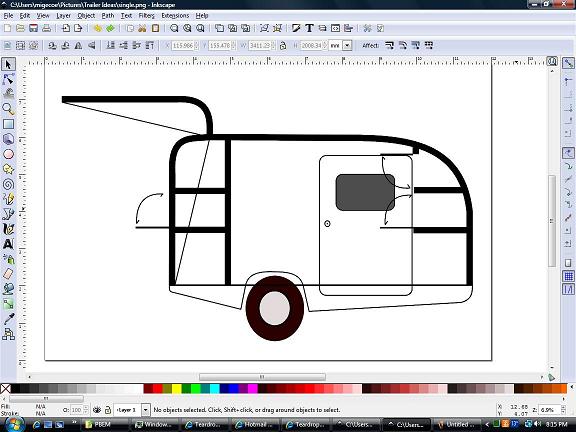

I also plan on installing skirts to lower the side profile down to the level of my TV. They will slope up from the wheel to allow clearance for obstacles.
Profile
single sheet build #1 small.jpg (42.53 KiB) Viewed 2212 times

you can build a 5x10 on a 4x8 trailer, most build threads show a (useless weight in my mind) "frame" of wood (1" x 3" wood normally) on top of the metal trailer, to screw the plywood floor to.
Most of them are building a tear that matches the trailer for size so this wood "frame" is a waste of weight and height, IMO, and both hurt gas mileage.
The one time a frame like this makes sense is to stretch the tear floor out, in your case this wood "frame" of 1" x 2" or 3" wood wold support the 1 foot of over hang of the front and back of the trailer frame. Fully glued to the 3/4" plywood floor, it would be all you would need to support the extra length. (screws, nails and staples, loosen up over time, and are a possible entry point for water=rot)
Unless you have very wide legs the box that cuts into the bed for the wheel wells will not be noticed when sleeping. I have them on my 5x8 tear and have never bumped them in bed.
my "queen" bed is actually an inch or so narrower than a true queen, it really doesn't matter that much, unless I have the measuring tape out I don't notice the difference.
I built on a 4x8 trailer, the 6" overhang on each side has no frame under it, it is 3/8" marine plywood. it is instead suspended from the sidewalls, which are supported by the front wall and the galley wall.
In your case, with foam walls, a "beam" (could just be a few inches tall of plywood) of wood at the base of the front wall and the base of the galley wall, fully glued (marine epoxy and fiberglass tape would be strongest) to the top of the plywood floor, with another "beam" (once again a two inch strip of 1/4" plywood would do just fine, though you would want it to flare up over each wheel well) at the base of each sidewall, fully glued to the floor and the front and galley beams, on the mattress side of each wall, would give you all the anchoring you would need for the sidewalls, and would give the floor all the support it would need for the overhangs.
If that isn't too clear, imagine your trailer, with the plywood floor in place, now make a shallow plywood box the size of your mattress on top of the floor. This will be what all of the sidewalls wll be glued to, with the sidewalls sitting on the trailer floor and outside of the shallow plywood box.
