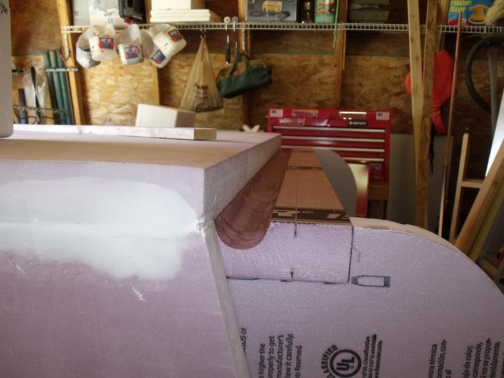

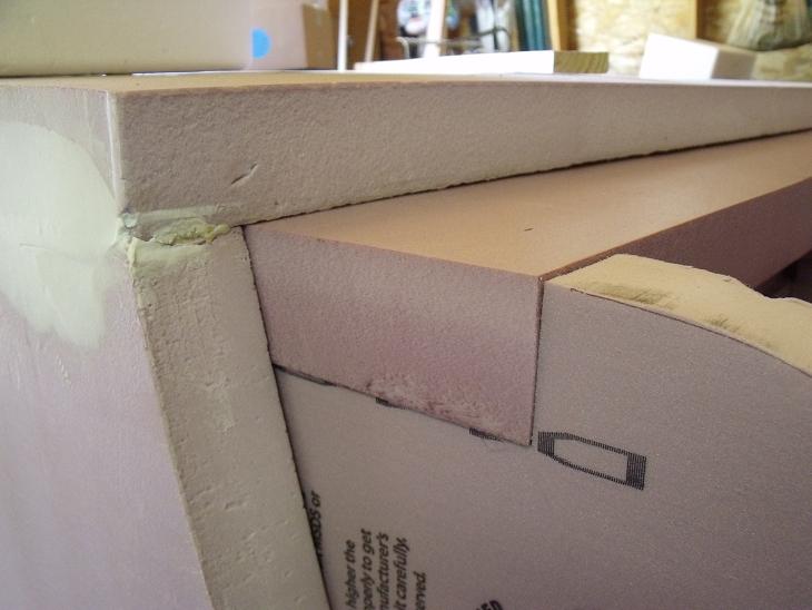

GPW wrote:Good idea, but you might consider eliminating the Galley , which is Much easier to build and from a Foamling’ point of view, galleys are problematic... :o All the rest is pretty simple !!! ;)
I think my galley design is pretty straight forward and simple. I think it could be even simpler if I did not have such a tight radius on the hatch. If I built another I would probably simplify even more by eliminating the radius or a angled flat piece.

GPW wrote:Before you go taking out springs consider the principle of the Foamie’ Ballast System (500# :beer: ) .... Foamies are incredibly Light for their size, and sometimes you want to add a little weight ...just to improve the towing under certain conditions... :thinking:
I flipped over the bottom spring. Easy and you don't have to mod anything....
