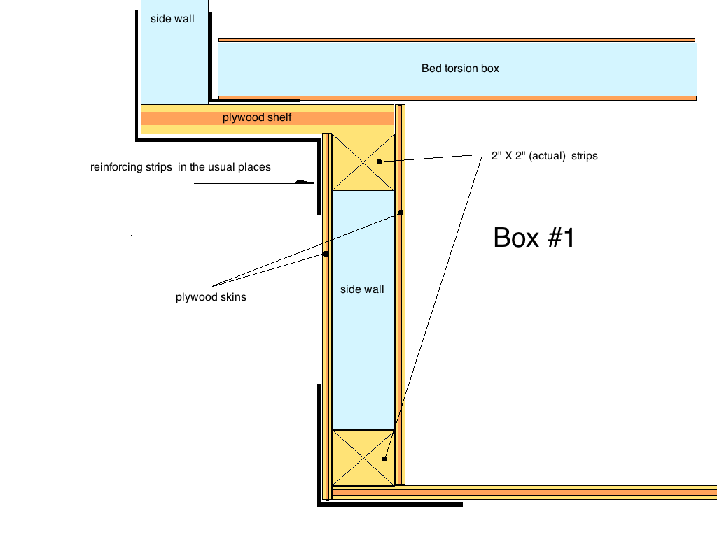

Have you seen the sketches that GPW did when Eagle was considering a slide in? (I referred to them a couple times recently in other threads.) I don't think that 2x4's are required any where in small camper construction. The only place I have any in my build is the blocking in the doors where the latch mechanism is recessed, and most of that was cut away with a router to create the pocket for the latch.
These are from GPW, remember to add some hard wood rub rails along the bottom and lower sides to prevent damage when sliding in and out.

The first stick figure bike isn't to scale but was supposed to represent a kids mini bike so I'm glad that's how it looked...lol. I haven't seen GPWs sketch you were referring to but the one you included is very helpful. The only reason i was thinking 2x4s is because I wanted to make sure it was strong enough to support whatever sleeping platform I go with...come to think of it most modern bed frames are made of much thinner materials.
