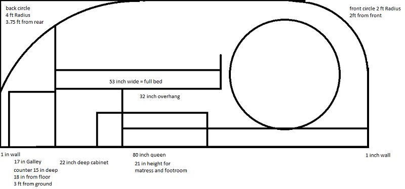

So here is my rough sketch I am using a 5 x 10 trailer I scored off CL. I am having a queen on the floor with a 5 ft long "Full" bunk for the kids. I think with foam I will move from a more Benroy shape to a more traditional tear shape. My concern is building the walls. I feel they need to go outside the frame so water wont collect between the channel frame and the flooring and rust out. But I also have the wheel boxes to wall around and seal up then. Any opening design thoughts?

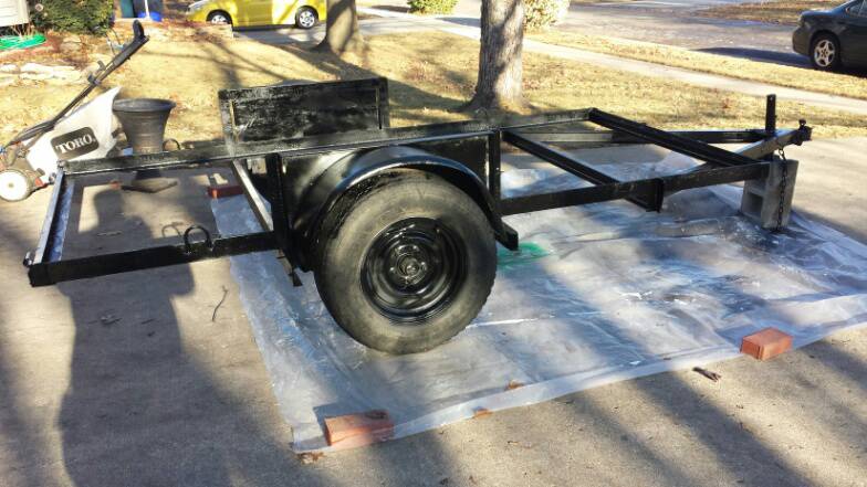

Here is the trailer I am still working on removing some of the extra side bits but I need to get a new grinder...I killed the other one this weekend. Any recommendations on a good deal on a grinder I would love to hear that too!

I'm not clear on your intended bed arrangement. Is the lower bed running crosswise and the upper bunk the long way over the lower bed's feet?
I can not envision there being enough room to: (A) sit up comfortably in either bed, or (B) not knock your shins on the upper bed when sleeping in the lower one.
Have you worked this out in true scale, or done a full scale mock-up in cardboard? If not, I would highly recommend that you do before committing to this arrangement; and don't forget to allow for the thickness' of the mattresses.
I'm not saying that it can't be done, and I'd be happy for you to explain what I am missing (if so), but I would also hate to see you to get half way into a build and find that it is not working out the way you thought it would.

Hey Jay, do you plan to build over the wheels? And how many kids are bunking in there? Cause the 5' trailer won't fit a bed sideways unless you build over the wheels. If you do go over the wheels and put a full length bed in, I would put the bunk on a hinge and have move up so you can have more room when the kids are elsewhere.

Right now the plan is an airbed size queen on the floor (airbeds normally run a couple inches narrower than a true queen which will give room for walls space to tuck in sheets etc) and an upper bun for my boys. Mom will most likely not join us as she doesn't sleep well in our bed much less an air mattress and no ac only a fan. So me and one boy on the queen and the other two in the full bunk. The full bunk I have sketched in at full width but it will be chopped short to the 5 ft width of the trailer. This should last them for many years since the youngest is only 3. I was thinking about hinges on the overhang so it could fold up and give more access to the cabinets underneath. Floor to ceiling will be just under 5 ft I think so about 2 feet for my legs knees down and 3 for the bunk.

BAJ, it might be good to mark out the trailer dimensions on the floor , load everything you intend to bring in that area , and see if that space is big enough for your needs ... :thinking:

I suggest you build a mock up. use cardboard and 1 x2s to get the idea of just how tight it will be. My biggest surprise is the how short 8 feet really is. now that I have mostly built mine I have made many changes that I would have not had to do had I built a mock up.
