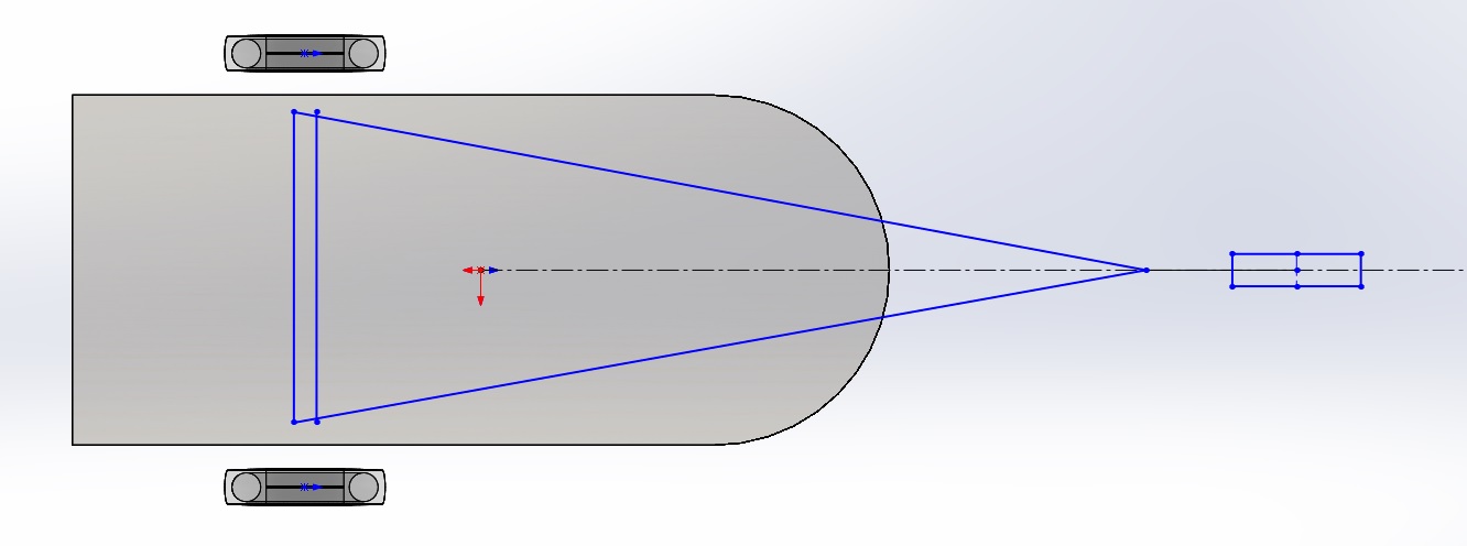

Postby jae » Thu Apr 10, 2014 12:43 pm
Obviously a LOT of tweeking, measuring, etc. that would need to go on here, but I'm thinking about using the Northern Tool torsion half-axles, tied together (and positioned) by some angle iron (the two vertical lines shown between tires), and then two longer pieces of angle going to a central tongue.
On top of this I would likely have some type of small tongue box, probably more for looks and a small 12V battery than anything.
For reference, that floor is 42" wide, 84" long at the furthest point of the arc (21" radius)

Re: Frameless foamie?
Postby KCStudly » Thu Apr 10, 2014 3:06 pm
I think you could do the bottom of the floor in foam and canvas like you plan. Just have hard block pads (good ply built up; or select solid oak or maple) where the foot print of the axle mounts and tongue tie in points will be; anti crush blocks if you will. You could even build a frame of 5/4 stock x 3 or 4 in an 'A'-frame shape, attach that to the underside of your deck then back fill with foam. That would give a nice solid tie in between the steel triangle and floor, without adding too much lumber.
I would worry that smaller flat plates just on the bottom would crush the foam over time, allowing the fasteners to get loose.
When you do get to the detailed measurements you will find that the torsion axle mounting points are actually in front of the axle center line; they have trailing arms that place the wheel centers behind the torsion pivot point.
Postby jae » Thu Apr 10, 2014 4:27 pm
Lonewolf: That build is what got me thinking about it. Rule of thumb that I've found is that a 4 x 8 x 1/4 sheet of plywood is ~ 25 lbs, so by the time I cut it to the size I've planned, each sheet should be ~18 lbs. Adding extra sheets certainly doesn't seem like a good idea when trying to keep it on a diet.
KC: I think you're right, I'd need to do some kind of solid block between the axle and ply. I'm kind of thinking about using a hole saw in a 2x4 and making some wood cylinders that I would insert in the foam to bolt through between the ply and steel. Just use one size smaller hole saw (~1/8" smaller) when I get axle placement decided to put the hole in the foam, glue the wood cylinders in and use the pilot hole to place mounting holes in the inner 1/4" ply, place on frame and drill down from the inside to place holes in steel frame.
Trailer balance (tongue weight, tongue length relative to axle width) is more critical on a motorcycle, so I'm going to have to do quite a bit of measuring and weighing before I just go bolting stuff on.
Postby bonnie » Sun Apr 13, 2014 12:34 am
KCStudly wrote:I think you could do the bottom of the floor in foam and canvas like you plan. Just have hard block pads (good ply built up; or select solid oak or maple) where the foot print of the axle mounts and tongue tie in points will be; anti crush blocks if you will. You could even build a frame of 5/4 stock x 3 or 4 in an 'A'-frame shape, attach that to the underside of your deck then back fill with foam. That would give a nice solid tie in between the steel triangle and floor, without adding too much lumber.
What KC said. My current project has a torsion box floor and the bottom was covered with 6 oz fiberglass. The axle area was built up with 2x4s. The tongue was bolted on with angles and some plate. That area has cracked and split. Most likely from the foam compressing.
