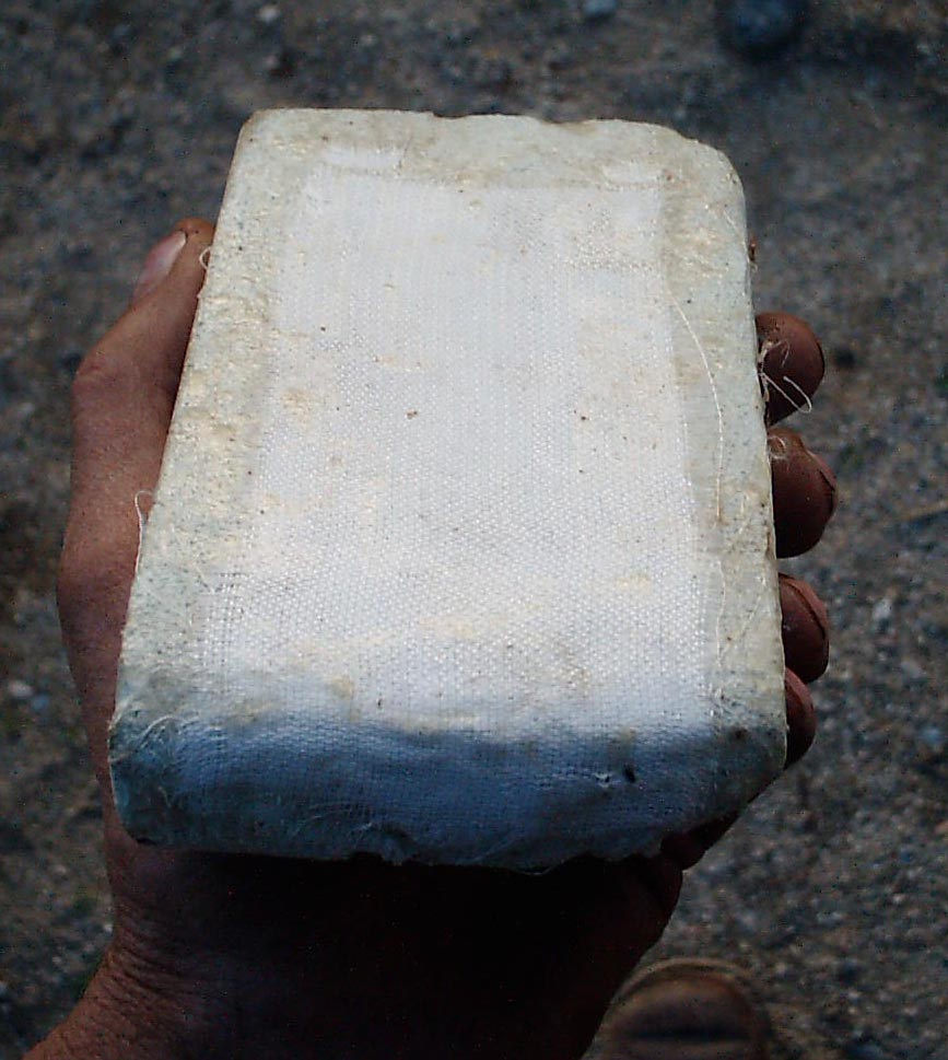

First post so hello. I'm building a foamie and I've been reading through the archives about different glassing techniques. I'd rather not use epoxy so I like the titebond idea. Since casein is so easy to make, I was wondering if anyone has tried using it as a resin. It's pretty tough stuff and I made a test section and was very surprised at how well it bonded to the foam. Has anyone tried glassing a foamie using casein as a resin? Sort of an organic fiberglass???

OK, thanks Sharon. I didn't think to search using Elmers as a keyword. Before Elmers switched their formula to PVA, it used to be casein glue made from milk-that's why there was a cow on the label. So milk protein glue and casein glue are kinda the same thing. I'll review the threads about Elmers but I'm pretty sure that it's not casein glue anymore. The big surprise in my experiment was that my homemade casein glue stuck so well to the foam. Thx for the reply.Andy

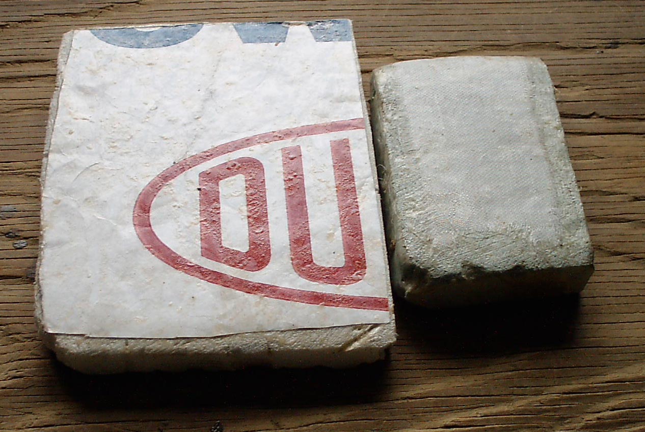

Yes, it was probably the most common glue in the world before the War, then synthetics became popular. The casein bonded very well to the Tyvek and surprisingly, it dried very quickly. I buttered a piece of foam with casein, layed down the Tyvek, then slopped on some more casein so the Tyvek was embedded well. I was expecting problems doing it this way. I was afraid that the casein on the outside would skin over and the glue on the foam side of the Tyvek would take ages to dry. But that wasn't the case-the composite dried very quickly, perhaps quicker than the other composite that I made. This was not what I expected since the Tyvek looks and feels much less porous that the other fiberglass cloth that I used. I suspect that the Tyvek will not lay as well as woven cloth since it feels stiffer so compound curves may present a problem. I don't know this for a fact yet-I need to do more tests. It finishes out very smoothly since there is no weave, or at least a very tight weave that is not noticeable. Interesting stuff that Tyvek.

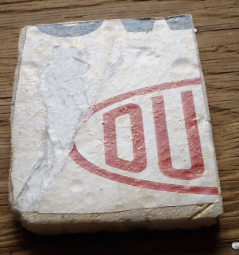

So I tried to peel off the Tyvek and the glue joint held strong. The Tyvek failed and came off in a very thin sheet, half of it still bonded to the foam. The peeled layer can be seen in this pix. I started in the lower left hand corner and pulled up, taking part of the DuPont emblem with the peel.
