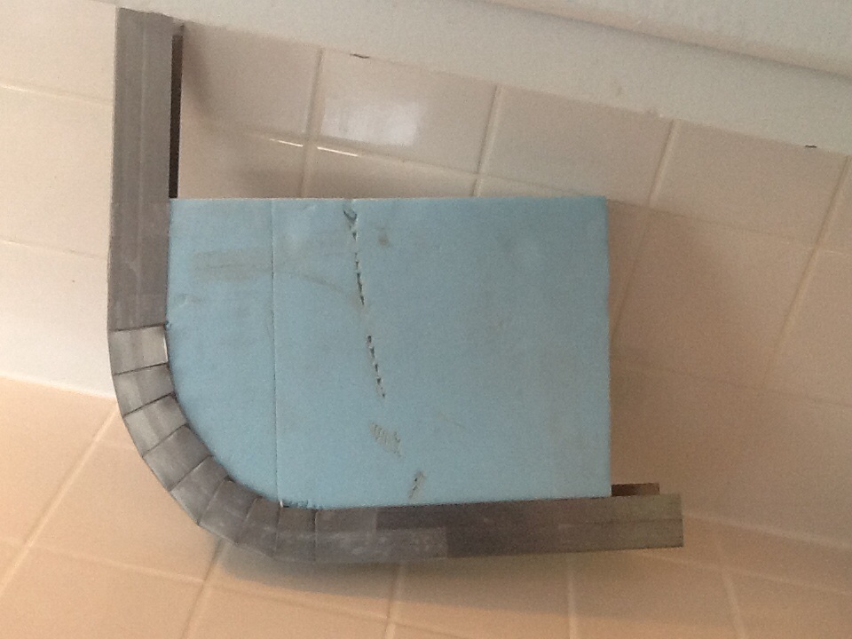

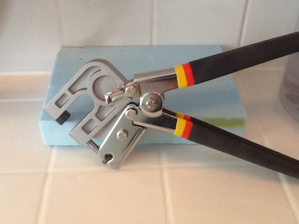

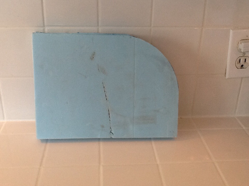

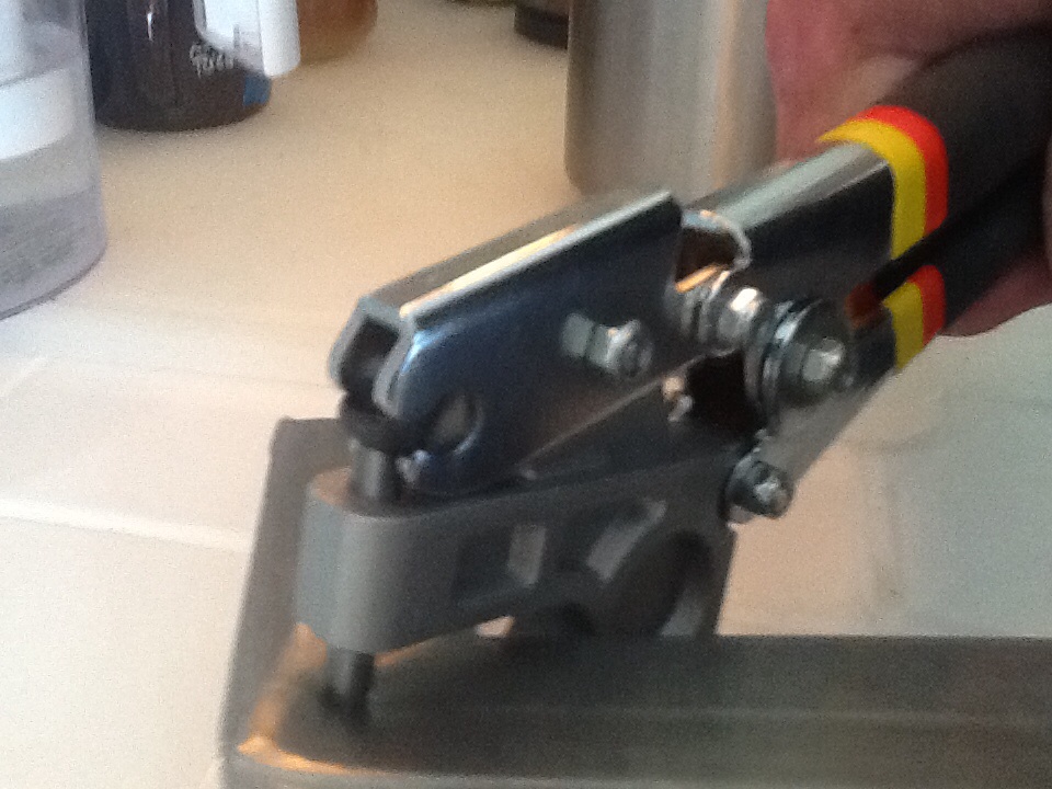

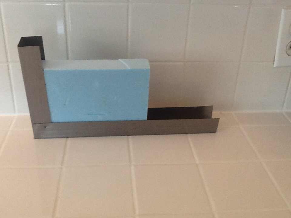

As I was roaming through a Menards Home Center, (like a Home Depot or Lowes) I ran across the steel framing section and had an " AH HA " moment.
So I bought a 10ft section of 1-5/8" steel bottom / top plate and brought it home to experiment with some 1-1/2" foam that I already had. I also bought a Crimping tool used to lock together sheet metal.
Here's a few pics of what I was able to do:

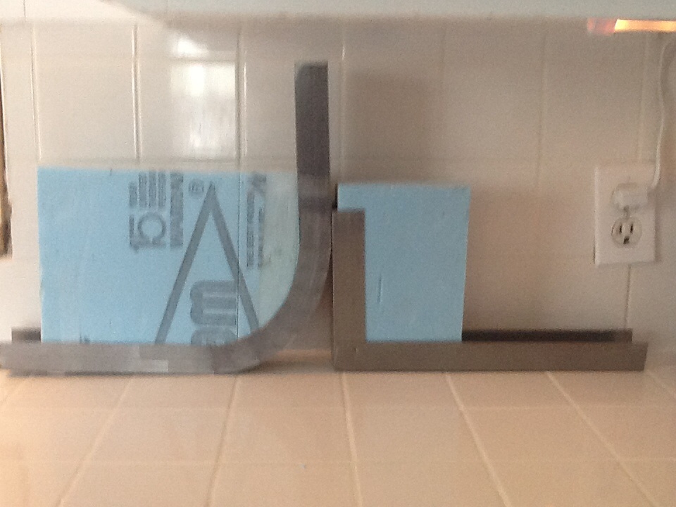

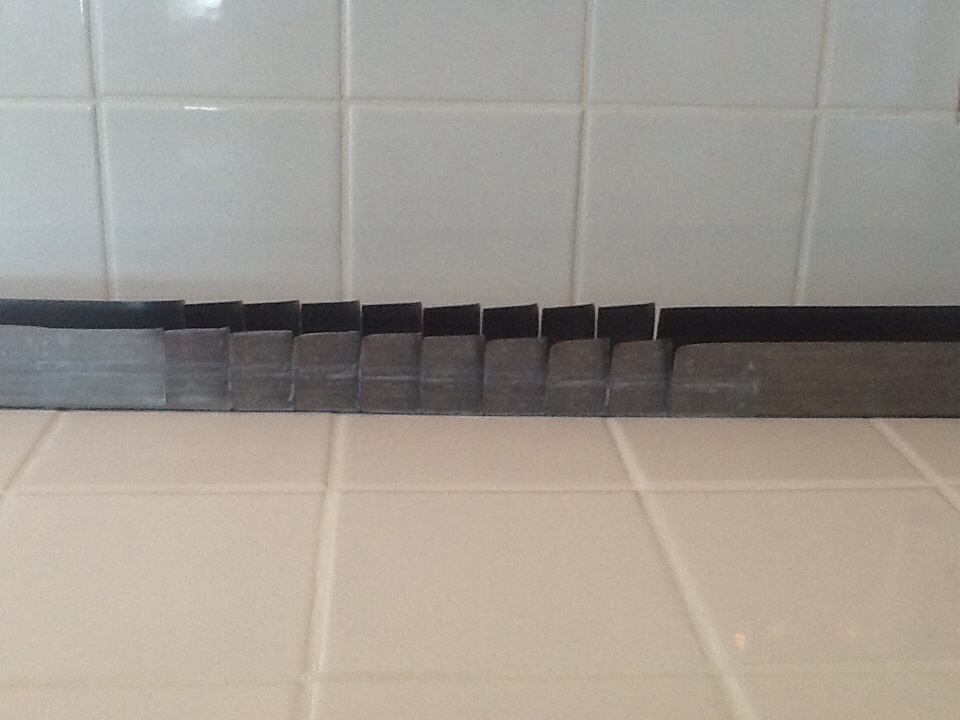

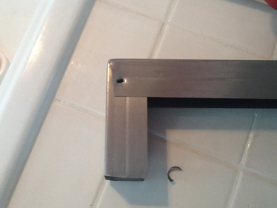

Here's more pics:

Pop rivets could also be added for additional strength.
Still more pics-What do you guys thinks?

The 1-5/8" metal track fits over the 1-1/2" foam with just a tiny bit of "play" in most cases - some sections were "snug".
