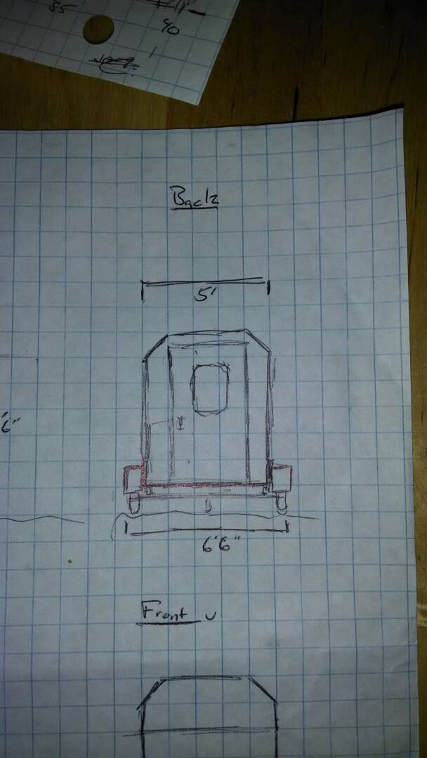

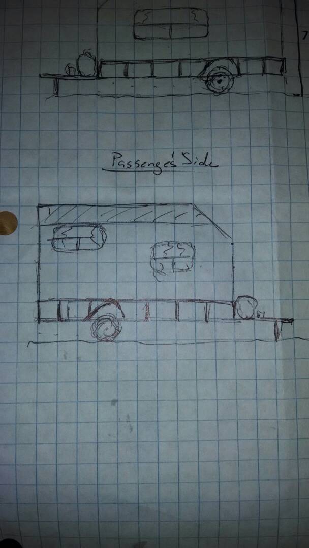

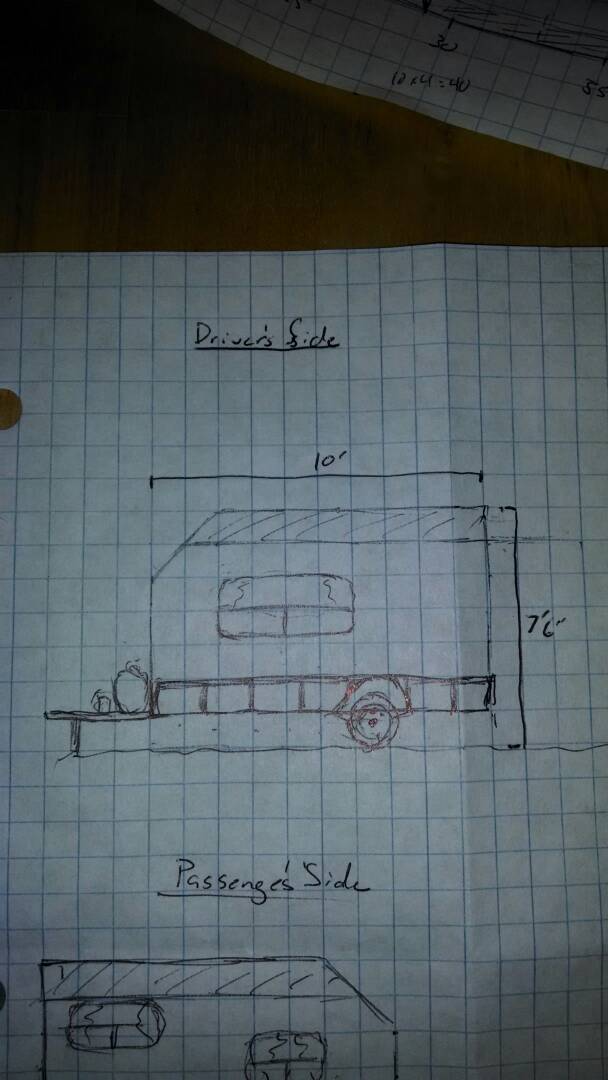

I'm planning a standie all foam on a 5 x 10 trailer. Rough sketches attached below. My general thoughts are to join the foam with GS, maybe reinforce corners with drywall edging. Wrap the outside (foam floor and all) in either canvas or fiberglass cloth + TB2. Either same thing on the inside or maybe luan with a thin plywood floor.

Nate , WELCOME to the Foamling' Family !!! Your design looks very doable and should be pretty comfortable ... :thumbsup: 8)
Regarding question #1 ... Most conventional teardroppers think we’re ALL Crazy ... But we know better eh ... :roll:
Question #3 ... How are you going to lay out the Inside? That’s important!!!

Thanks for the input. In terms of width, keeping it at 5 ft is a conscious decision since I'll be towing with a 4 cylinder Rav. I am planning a 45 degree angled box for the top 2 feet at the front - would you recommend starting the angle lower/taking it further back on the roof?

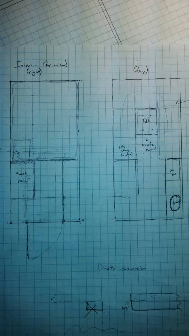

Postby natemiller » Sat Jul 26, 2014 2:43 am
Inside sketches. Figured I can get another foot on that front angle.

Postby KCStudly » Sat Jul 26, 2014 8:03 am
You're on your way now! From here, the best advice I can give you is to read all of the Build threads and the Construction Secrets section. There is so much learned experience there.
