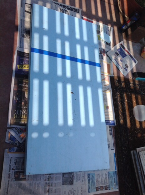

Postby RogHodge » Sat Aug 09, 2014 3:13 pm
So I shot some paint yesterday, which is largely irrelevant. But as part of my day was available and I sometimes need a distraction, I decided to build a bodyboard. For what it's worth "Boogie Board" specific brand like Kleenex or Xerox, but who really cares, right?
So on with the pictures...

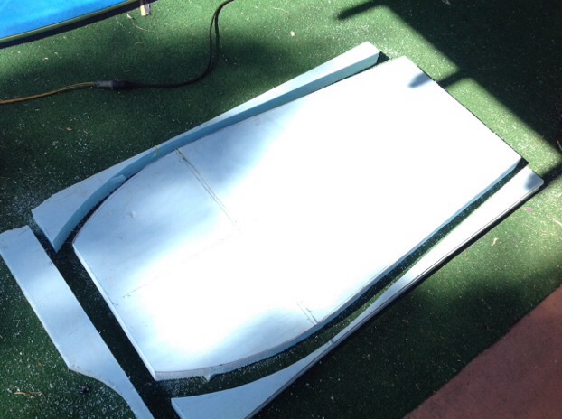

All I can get around here is 1" so I glued up the scrap from my build
1

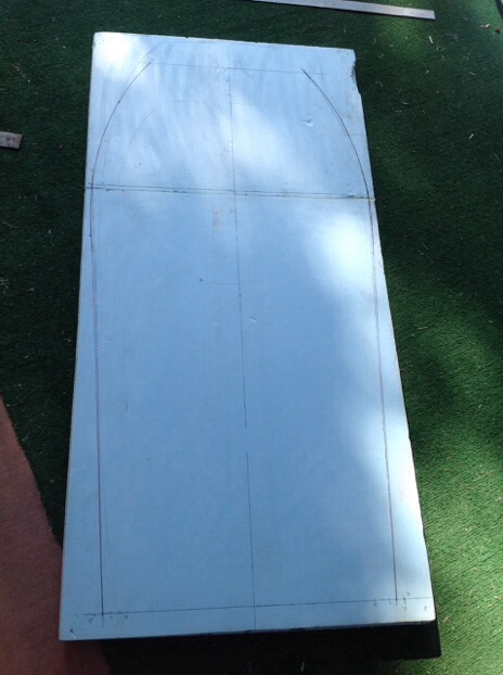

Then laid out a design. I'm no spiffy pro board shaper but the inter web seems to have some information if one cares to look
2

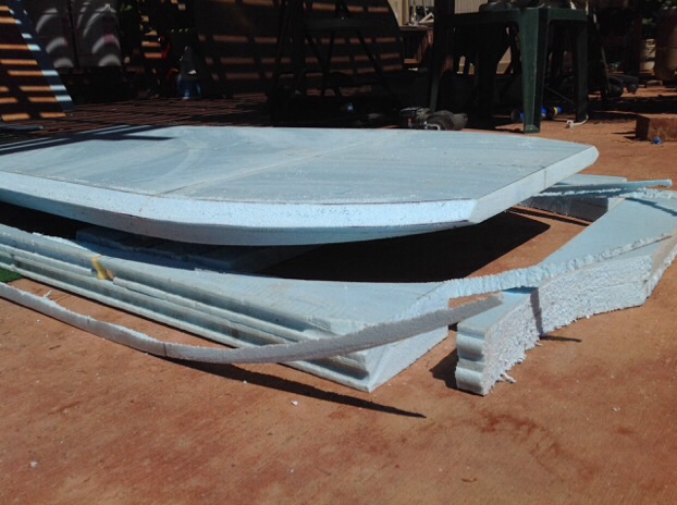

Now all that's left is to cut it out...
3

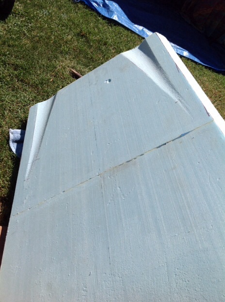

Postby RogHodge » Sat Aug 09, 2014 3:22 pm
But that's not all!

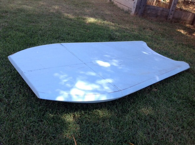

A basic sanding and shaping of the outline and round the nose...
1

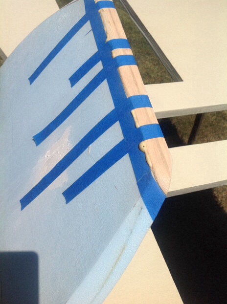

Then cut the 'rails' it's a 60/40 if anyone cares. Means 60% is the bottom angle! again who cares.
2
And after a bit of sanding...
3

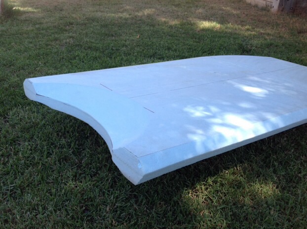

Postby RogHodge » Sat Aug 09, 2014 3:32 pm
Add some channels , this is the underside in the rear
1
And a crescent tail, as opposed to a bat wing.
2
And we are ready for canvas paint and waves 8)

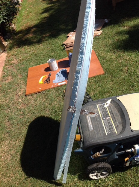

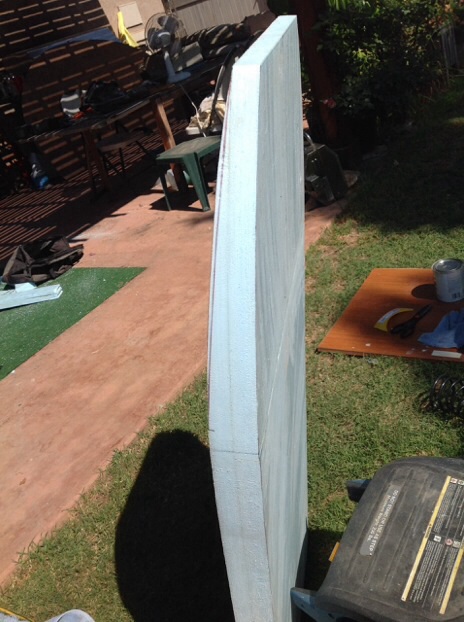

Postby RogHodge » Tue Aug 12, 2014 11:04 am
Sheets going on. I did put down a layer of fiberglass tape. After finding an 'extra thin' variety.
I'll try to post a pic a bit later
Not surprisingly the sheet material is much easier to work than 8oz canvas!
First I placed a bit of protection for the nose, and shaping it was a pain, not in the nose but a pain none the less
1
And covered the bottom with cloth , too bad I can't keep the fairies :R
2
