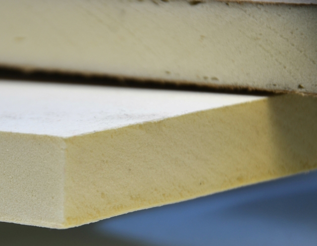

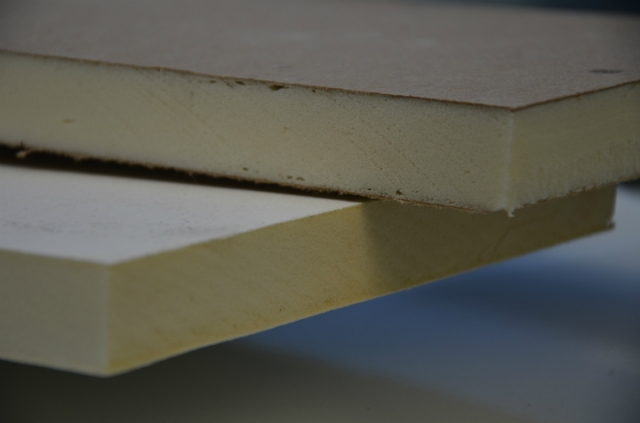

Any suggestions for the test samples, GPW? I got two samples of the panels today, one is 1" thick fibreglass faced (CAD13$/sheet 4x4) , the other is 1" thick brown paper faced (CAD10$/4x4).
Fibreglass faced is feeling prety stiff as manufactured already.
Cheers!

I do not really know what I want to test after I checked them out.., cut with table saw and knife, produce very clean cuts.
1. The board with fibreglass sides is something like an acrylic/latex paint with very thin fibreglass felt/mat and may only require another layer of fabric with paint.
2. The board with brown paper got me really thiking about possibilities... it is 30% cheaper and the paper could be impregnated with polyurethane and then coated with fabric. I am also thinking of cuting it and gluing it as a torsion box structure, where structural properties are more important... :thinking: like this with lamination on top and bottom, similar to honeycomb, more work though:
Overall I have no doubts that the fabric will stick extremely well to both kind of facers. The fabric would be easily separated if peeled off from the foam as the foam itself is much weaker than the lamination, but this would be the same with pink foam. The hardness of the foam is similar to rigid pink foam I already have (Foamular 300), but I tend to think it is slightly softer (maybe equivalent of Foamular 200) and the product datasheet states that it is 20psi on 10% deformation which is the same as Foamular 200 foam. Here are the photos:
The material seems to be suitable for a teardrop foamie, but I have no experience here and everyone should decide for him/herself. As far as my built concerned, I dont really know what I want to do yet. I already have the pink foam and it really depends how finaly I will build it and how much and what reinforcements I'll need.. too many variables yet with my build, keeps me awake sometimes :? .
What do you guys think of the material?
Oleg

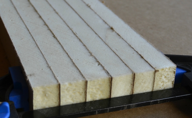

Postby OP827 » Sat Oct 25, 2014 12:42 pm
Since we all like pictures, here is the picture of lamination samples faced with 1 FG layer and waterproof PVA (TB2 equivalent), left to right:
- 1" polyiso brown paper faced cut in strips to form structural torsion box structure both sides.
- 1-1/2" Foamular 300 pink foam
- 1" fiberglass faced polyiso
- 1" brown paper faced polyiso

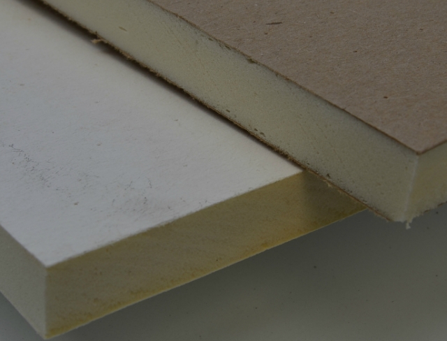

I did destructive tests today by tearing the laminations apart from the foam and here are the results with pictures:
1. Fibreglass facer polyiso foam. Adhesion of both glue lamination and facer is stronger than foam, the separation was in foam. Note the little bumps that are from manufacturing, if there were many smal and deeper penetrations like those, the force to separate the foam from the laminate would have to be greater. Force requried was in the middle of the samples range, but more than with pink foam lamination.
125773
2. Brown paper faced polyiso foam. This one has separated through the paper as being the weakest. Force required was less than all other samples.
125772
3. Torsion box glueup showed the strongest bond to lamination of all due to paper ribs adhesion to the laminate, was actually somewhat difficult to tear apart.

Hope it gives everyone an idea of these polyiso panels. I would consider using FG faced ones. They could be a good solution for flat panels as they are straight as manufactured, have smooth white surface (no imprints like on pink). I understand why the gentleman who built the "world fastest folding shanty" liked them. The cost in my area is similar as pink foam, considering the fact it will require no sanding and already has one strong layer of fibreglass mat glued. With thickness like 2" they could be good "as is" for a small foamie with corners and joints taped and glued.
That could be a very fast foamie built, but again, for more or less flat panels. They do have some flex, and light curves are possible with thinner material, or another crazy idea is to delaminate and then laminate the FG mat after the curve is done in place.. don't know, that would another experiment. When teared apart the FG laminate comes off the foam only with elastic deformations, i.e. intact, like a thin Filon, so it could be easily re-glued ... on the small sample I did. The foam in my sample test case separated cleanly which may not be the case with bigger panels.
I will be using the pink foam I already have as I see no big reasons to switch (sell and then buy again :o), both materials have their place. Polyiso has better temperature range and was around in sandwiched composites for a while now, but there are some cons too, check MSDS.
