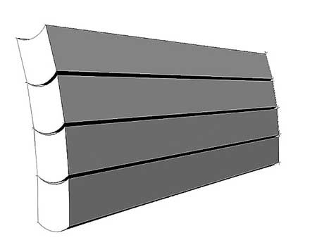

I was thinking about an alternative to kerfs for doing curves. I wonder it you could make a hot wire cutter to make bead and cove strips.

Having work with foam for a bit now, the cove work would be a lot more effort than other methods.
Thinner sheets of foam will flex quite readily, and it would be far easier to laminate 2 or 3 layers, even if you had to make a simple form to weigh them down on, than it would be to glue tens of strips together, then fair back.
Sanding the foam is easy, but you have to be careful which glue you use because most are harder than the foam when cured. That makes it hard to sand consistently on the joints, tending to leave the joints and take away adjacent foam.
That's why, for the 2 inch foam and gentle curve, I was envisioning wide vertical slats more like barrel staves. Less pieces and less joints.
2 layers of 3/4 inch, are 3 layers of 1/2 inch would get it, but you'd have to work a bit to get good contact while laminating... and GG tends to expand, thus the idea of a horizontal form that could be loaded up with weights.
One thought I had for an alternative to vacuum bagging was to use an old waterbed mattress as a press. Lay a sheet of foam on the form, spread glue, add another sheet, put empty mattress on top and fill with water, allow to cure, then trim to final size. Just a thought. :thinking:
