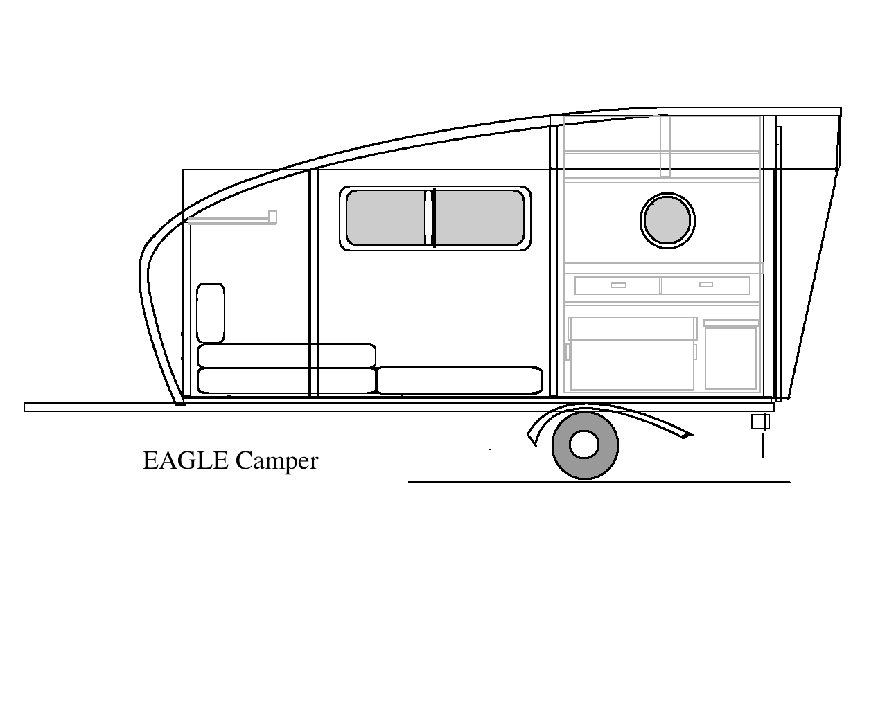

Going back reviewing the Zephyr drawings in preparation for a Spring build , we noticed we were losing a lot of headroom up front . So decided to make another drawing to search out the potential for a little more area overhead ... And this was what came out ... The Eagle Camper ... Named after it’s eagle’s head profile .... and our illustrious moderator of course... :D The sides could canted inward like the Zep’ , and the same type of simple framing could be used ... ;)
So we get more cubic feet inside and still retain a streamline structure .
Ps , the main entry could be on the side or in the rear as shown , the rear entrance protected by an overhang which keeps out the rain . Inside is room enough for a Mini Galley , and even a little potty .
Shown is a 5’tall 12’ long Sleeper version, but a Bigger 6’+ tall and 15’ version is easily doable ...
Not ready for Prime Time , still developing... :thinking:

I like that. Very much. Is the little bump on the front for an AC?

Thanks Bonnie !!! ..... AC ? Could be , I guess ? ... :thinking: In actuality I’m a fan of keeping the AC low , as mounted on the floor ... FS is that way and it’s easy for me to deal with , the old back and all ... :o I’m just trying to explore (with drawings) the more streamline trailer shapes and yet have plenty of room inside ... The gentle roof curves , except the small bend in the nose, should be easy to do with foam ... I’m thinking now since the 1” foam bends so easily the roof and nose could be done in 2 layers and require NO kerfing' ... :roll: We learned that either T2 or Gripper will dry completely in between laminated foams ... it just takes a good while ... but being out in the Sun helps... ;)

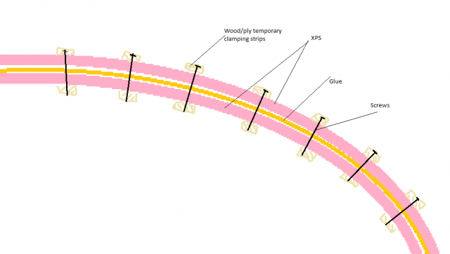

KCStudly wrote:The bigger problem I'm having is getting a good even press when laminating to the front wall. Sure, a smallish model airplane wing on a flat surface is easy to weight down, but laminating around a large curve, or trying to press to a vertical surface isn't as easy as it may sound.
I am actually considering using a vacuum bag for the front and small front radius. :frightened:
I am also considering an aray of deck or drywall longer screws with pieces of scrap plywood and wood at the both sides to clamp the foam sandwich together. After glue is cured the leftover holes will help to prevent canvas or FB delamitation when filled with glue.

Postby OP827 » Tue Jan 27, 2015 4:54 pm
GPW wrote:
Oleg, foam is Not like plywood , if it’s laminated , it stays laminated ... :thumbsup: Especially heat bent foam which has no built in stresses, unlike bent plywood ...
- I meant to use the screws when you have two or more layers of foam to glue and clamp together while forming the final curve. Maybe I should make a small sketch to explain what I mean by that? :roll:
ok, here:
