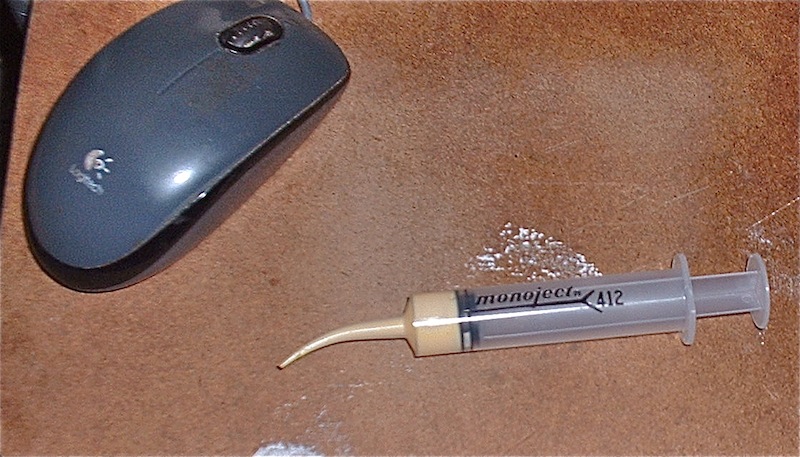

Has anyone had a bubble of air in the canvas where the glue did not take? If so I would love to know how you fixed it. I have contemplated using a large needle to inject glue, or just cutting a slit in the canvas and pouring some glue in. Let me know what you all think.

Andre, in the past we’ve used a large syringe from the drug store , filled with slightly thinned T2. If it’s a big bubble , you can make several tiny slits in the canvas at the BOTTOM of the bubble , and just shoot some glue in there and massage it around till the whole inside is glue covered again , then use a plastic squeegee (auto parts store) to press out the excess glue ... mop that excess up , let everything dry really well , then use a little filler on the slits you made .... paint over that , done ...

Thanks for the suggestions! I already ordered a syringe and will fix the bubble in a few days.
