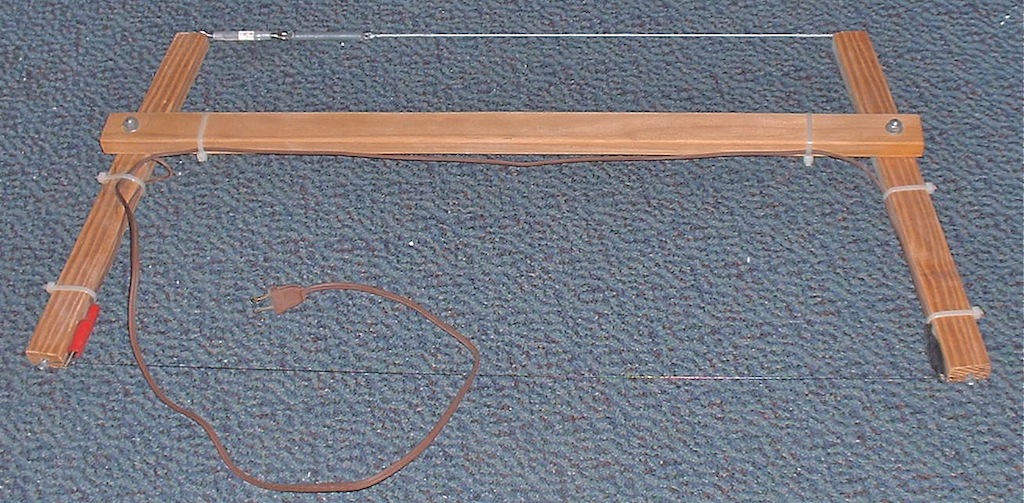

What about Bigger cuts ???
Re: Made myself a HotWire Cutter
Postby rowerwet » Thu Apr 16, 2015 11:25 am
Bow saw frame!
rowerwet
Posts: 2075
Images: 521
Postby GPW » Fri Apr 17, 2015 6:44 am
Easy enough to make .... in most any size ... :thinking:
NOTE *** The 2 prong plug on the wire is NOT made to plug into the wall ... That plugs into a Variac ...
