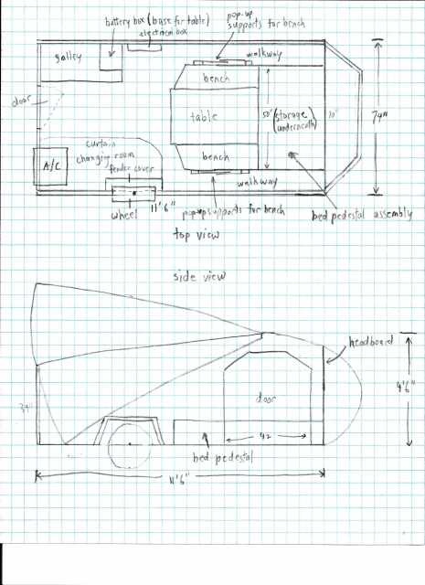

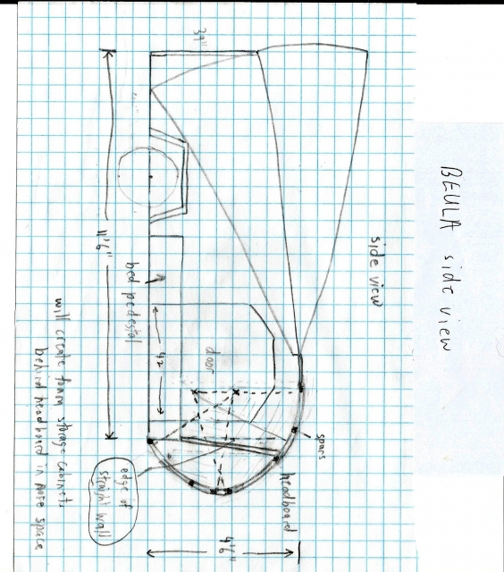

My initial graphing of BEULA shows floor plan and side view. Floor plan uses a 50" wide bed situated lengthwise. The bottom half of the bed converts to a dinette as Gary accomplished in his Winter Warrior design.
Plan for the hatch is to build sides with 2" polystyrene from the nose to the hatch. The back half of the box will use 1" poly attached to the inside half of the 2", thus creating a "nest" for the 3/4" poly hatch.
The actual height of BEULA is now 58" following some consultation with Gary about the hatch design requirements.
My journal then moves to the nose section, since I needed to determine whether my plan would work before going forward with the remainder of the project.
Ch

Postby OP827 » Wed May 06, 2015 10:03 am
I think your ideas are very interesting.
Two questions:
Is there going to be enough headroom with lifted roof to seat at the table or you may want to move hinge further in front above the headboard?
Having side access to the bed pedestal is certainly a great feature, but is the cantelivered side wall will be rigid and strong enough with such setup, so how are you additionally brace and enforce the side walls from not flexing and stressing too much on the sides?
