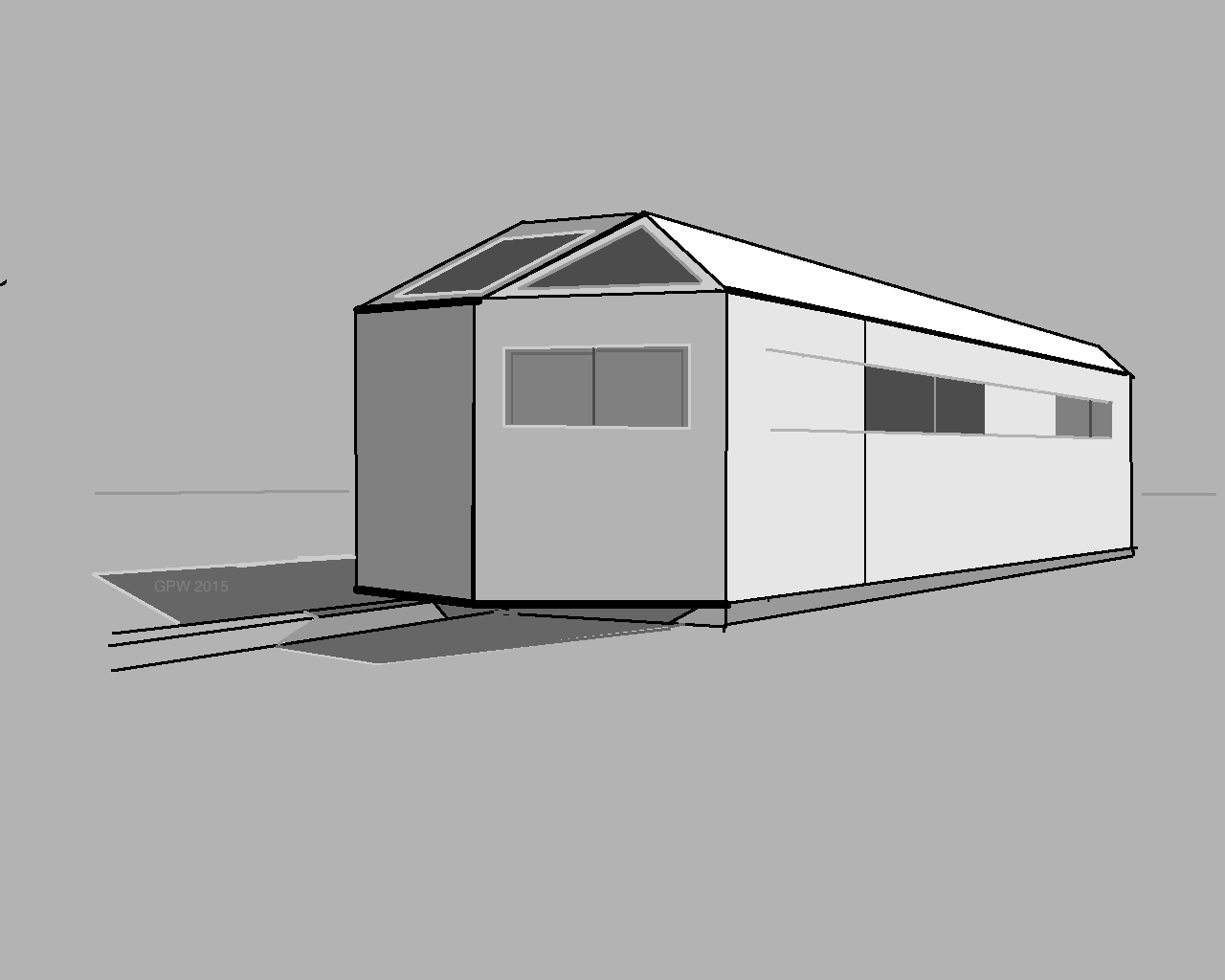

Postby GPW » Fri May 22, 2015 7:06 am
Just another drawing for a simple (larger) camper trailer . All straight lines , non curves , no kerfing. Yet should be almost as streamline as a rounded one . :thinking:
The size is easily adjustable for Larger or smaller. The foam , depicted in two colors, is only to show the use of whole sheets of foam .

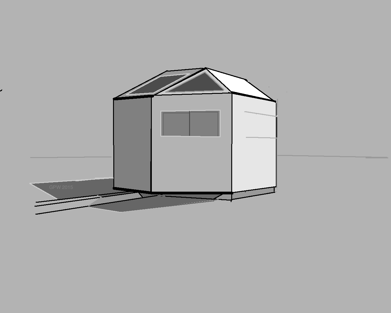

Postby GPW » Fri May 22, 2015 11:07 am
And the 8’ version if desired... :roll:

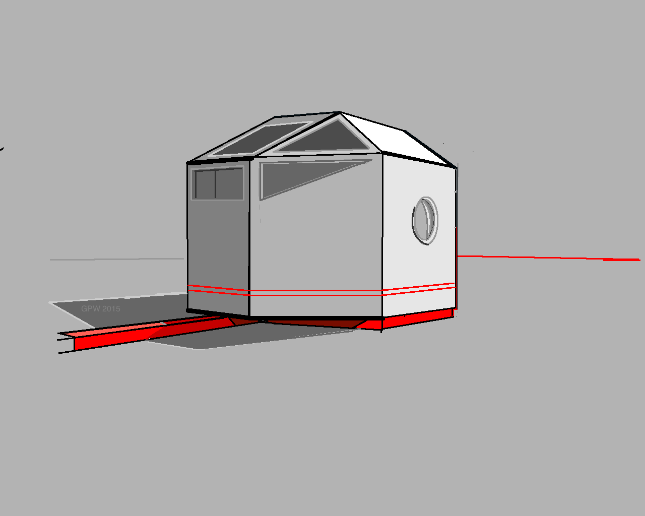

Postby GPW » Fri May 22, 2015 11:22 am
... and "dressed” ... :beer:

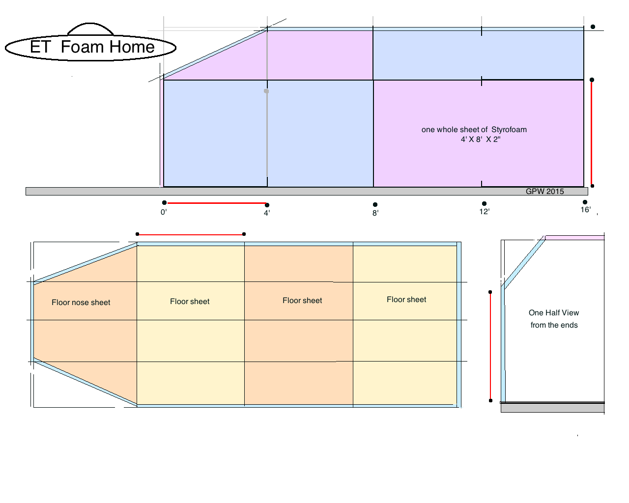

Postby GPW » Sun May 24, 2015 2:12 pm
Well you know we built the FoamStream , and although Perfect for our needs , it wasn’t the easiest thing for this old guy to build :o ... Having to cut sheet foam to thickness from blocks (which didn’t always come out exactly the same ) :roll: Then requiring CNC cut ribs , which not everybody has access to ... :NC And then all that kerf cutting , which was a real labor and bigger mess. :duh:
Further thinking was (in this case ) to emulate the good properties of the FS without all the complicated hassle (and weight and expense) of construction... What we wanted to retain is the sort of “tubular” ( ish ) structure that would give the whole cabin a lot of strength and rigidity without exotic framing or extra weight... Good standup headroom , the ability to sleep sideways for more efficient floor space , and have an efficient streamline nose that didn’t require sculptural skills ...
I believe this one could do that , uniform sheet foam , with angle cuts made on a table saw... (they’re just not that difficult ), the pop the whole structure together , glue , cover ... and Bob’s your ....

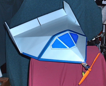

Postby GPW » Fri May 29, 2015 11:25 am
LDM , I beg to respectfully disagree a little bit ... No they are not as fully efficient as completely rounded noses , but are Much better than flat noses . We proved that years ago when aero-modeling and experimenting with “Diamond" airfoils.
And we must admit , it does look better than a V front ( like on a cargo trailer), and possesses (somewhat) the structural qualities of a rounded surface (tubular) ... It’s all a compromise ...
... and we’re still not quite sure on the back end pushing the air moving you forward thingie’ .... so then why do hi-performance cars have flat backs ... (ish' ) :thinking:
Good fodder for discussion eh ? :D
Here’s one we had great success with ... (see Pic)
