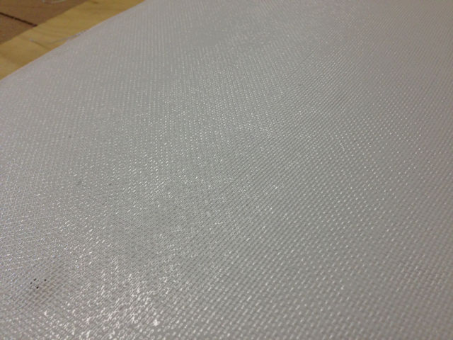

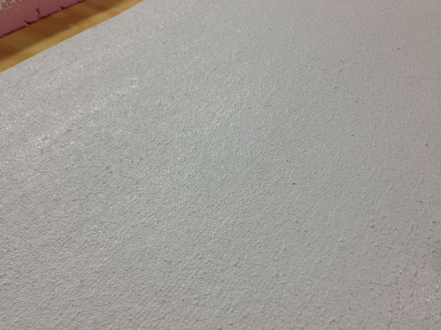

Postby mikeschn » Wed Jul 08, 2015 5:51 pm
Wow, I'm really impressed. That Glidden Gripper Primer is some really sticky stuff. I tried a couple samples with it tonight. I should have a better idea tomorrow as to how it compares to TBII and TBIII.
Meanwhile just for fun, here's what they look like glued up. Tomorrow I'll start experimenting with making it smooth. And no, I don't have any microballoons!
BTW, I brushed the paint onto the EPS, then laid the fabric on top of that, and finally rolled it out with a roller. The canvas rolled out nice and smooth. The fiberglass pulled away from the EPS in a couple spots. You can see one spot in the lower left corner of the bottom picture.
P.S. I wonder if fiberglass is as hard and durable under gripper primer and paint as it is under polyester resin???
