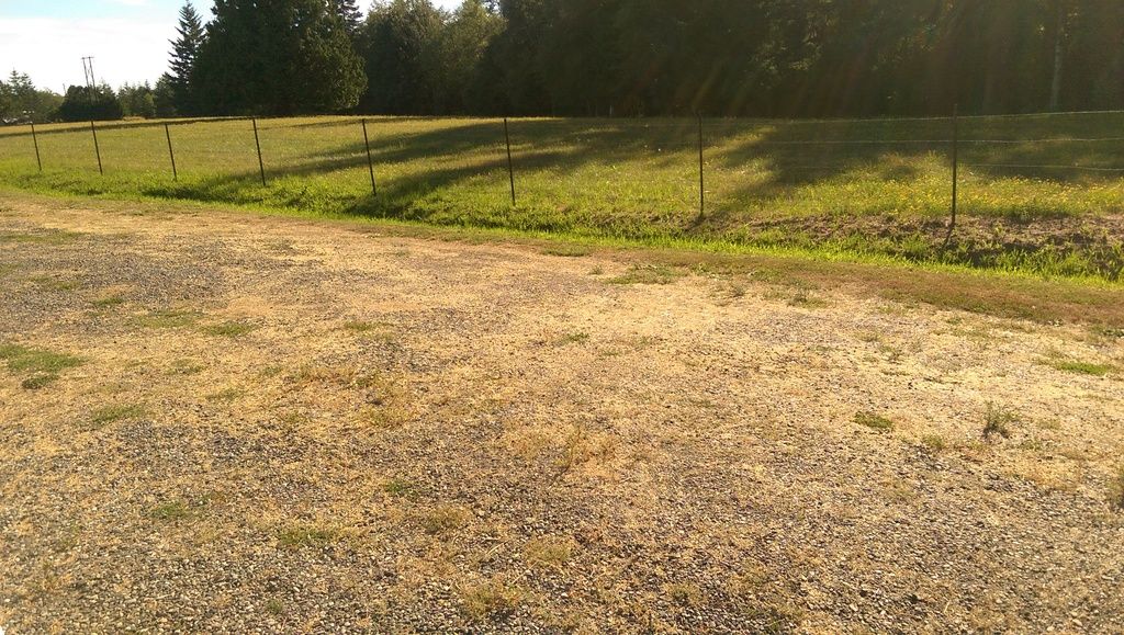

I know you folks like pics... ready for the first one? It's a pic of... nothing! :lol: Well, its my driveway where hopefully in a few weeks a container will be occupying that space.
I don't have anything yet. Not even a trailer. But I'll take this time to plan. Personally I know from experience the more I plan, the more successful I am. I will ask upfront for everyone's patience beforehand. I'm the guy that asks a ton of questions until I'm blue in the face. I measure FIVE times then cut once! :). And I promise to always try and research other threads before blurting out questions.

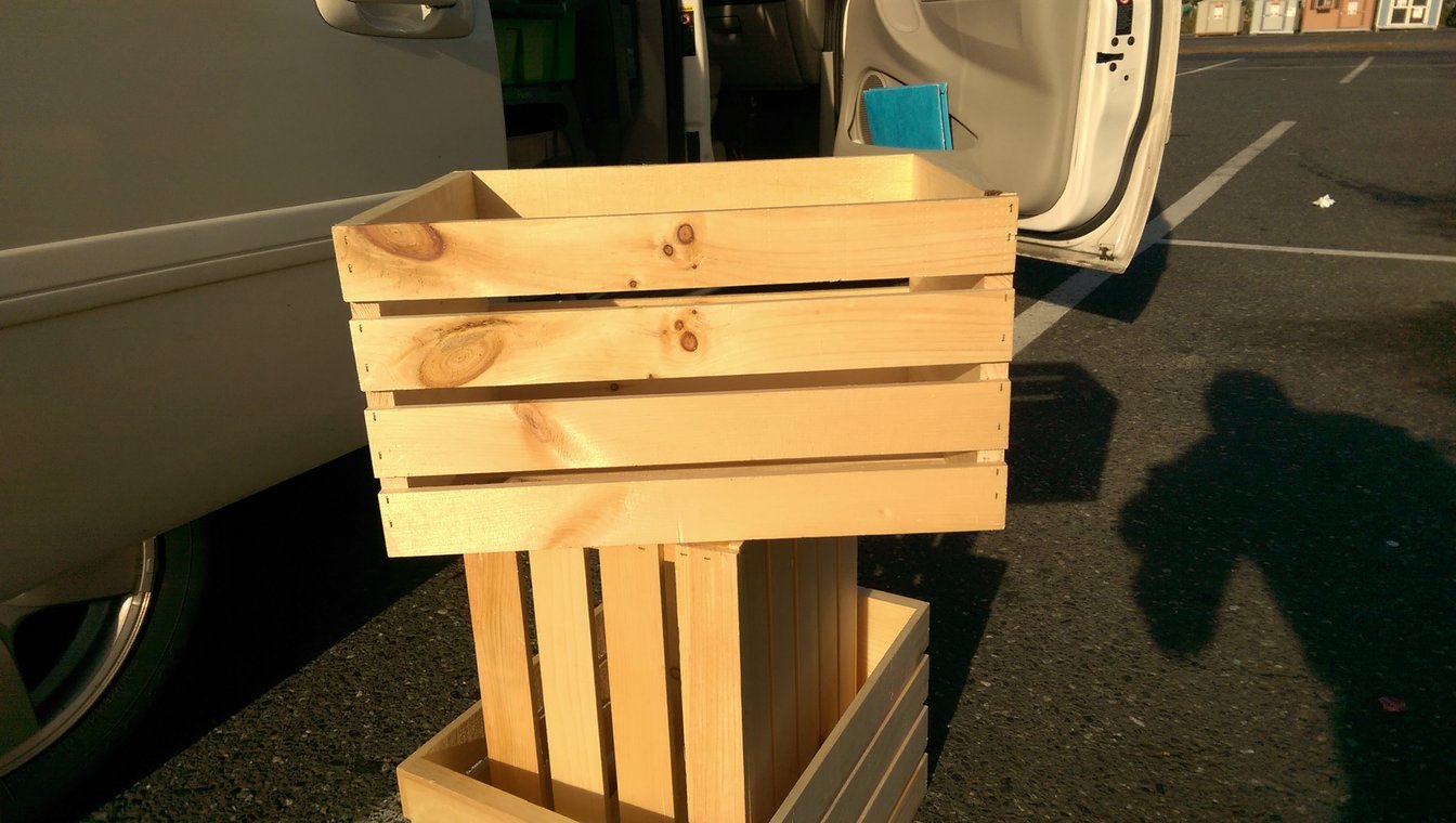

Now when I walk through the hardware store I look at things that could eventually end up in the teardrop and that I should build around them. I found these really cool wooden crate boxes at Home Depot for about 10 bucks a piece. I bought three of them. Keeping my receipt just in case I end up not using them.
