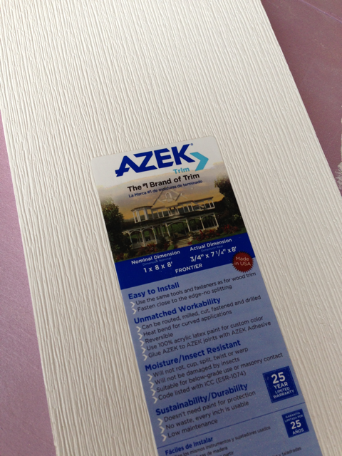

I'm back from the Orange box store. They had a piece of Aztek 7" wide, perfect for a water resistant wheel well! :thumbsup:

What’s Aztek ? You’re gonna’ have to show us what that looks like eh ? :pictures:
Re: Wheel wells? How to seal?
Postby Arothian » Sat Aug 08, 2015 5:20 pm
I think he is talking about this stuff, 'AZEK' : http://www.homedepot.com/p/AZEK-Trim-3- ... /202970147

Aro is right...
It's Azek
Azek is some kind of plastic...
Here's a shot of the end grain. Plastic thru and thru!!!

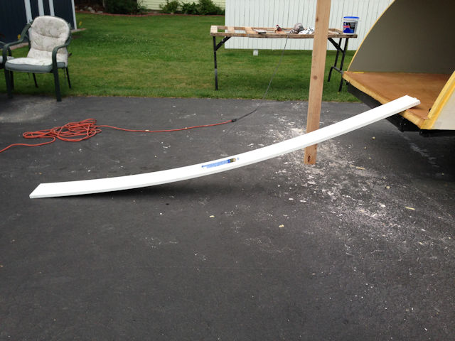

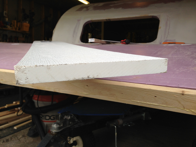

Herin lies the problem with building with azek... there's no strength... It's like a wet noodle!!!

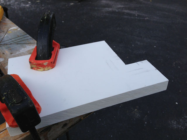

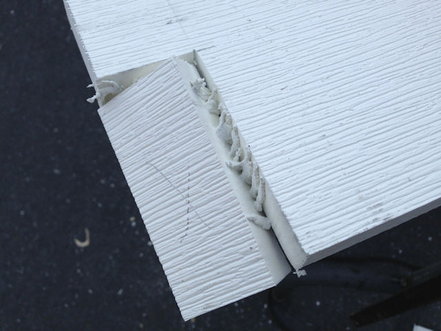

The Azek PVC trim cuts really nice with a table saw and a chop saw. This material is soft and goes thru the blade like butter.
But try to cut it with a jig saw, that's not as much fun. The blade gets too hot and the material melts! That has to be cleaned of with a hacksaw blade or a chisel.
Drilling holes was easy, and just to be safe I predrilled the holes for the screws. The screws hold well, and there was no splitting.
I glued it up with gg. As far as I can tell, it's holding. But then it's all backed up with screws.

Thanks for the evaluation..... Do you think it could replace wood in a door frame ???

Would it bend enough to make a curved wheel well, like a car has, but with no kerfing?
An opinion would be helpful. I am still in the thinking stages.
