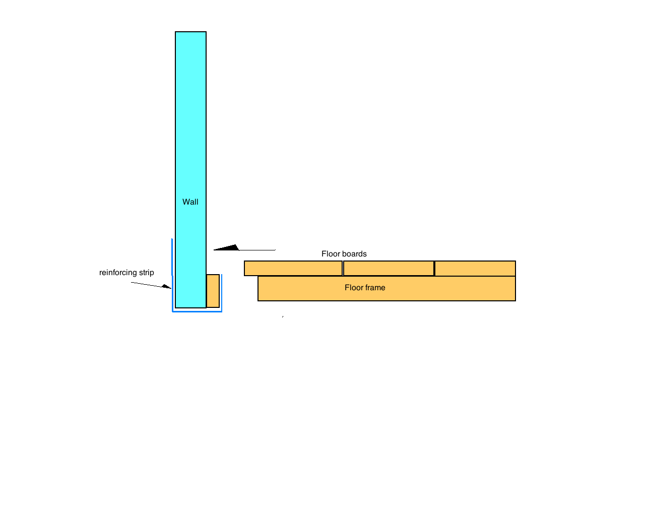

And just another thought .... Board floors would enable you to assemble the sides with the floor frame end rails attached , then covered underneath easily on a flat table ... then just screwed to the floor frame like all the other boards ... :roll: You could theoretically cover the side and floor board underneath with a reinforcing strip , and once assembled just run the side canvas down to the bottom and trim it off flush ... good not having to get on your back underneath the trailer to wrap the floor to wall join. :o

GPW hate to say it, but look at how many joints there are there just in that picture. As we all know joint = water intrusion point, plywood sheeting may have its downsides, but minimizing joints isn't one of them. Plywood is also dimensionally stable. If you butt those boards up side to side like that every one of them will expand & shrink with the seasons. Part of the problem you mention with ply is that it delaminates. Let's face it, how many of us are buying from the big box stores? Their ply is sourced from the absolute cheapest sources, they buy in bulk and just like traditional RV manufacturers they cut to the bottom line wherever they can. There are better rated marine grade plywoods available, they cost more, but will be much better at surviving water issues due to better glues. Cost difference between them... Perhaps 50% more, but if you have to replace the lesser grade down the road thats 100% higher or more!
Big rigs have wood floors, usually white oak 8/4 laid up on edge, screwed together and with steel support beams. They're also treated with the Gunk to help keep out water.

You are going to get at least 3/4" of lateral movement on a 5' wide board floor. It'll probably work if you allow for that movement in mind (both expansion and contraction).

Separate boards have no shear strength (one can slide forwards/backwards relative to the next one) so the torsional stiffness of the body will be reduced. Is it significant? Dunno. Would I use it? No.
Tongue and grooved boards with glued joints would eliminate this and any leakage.

Angib ... separate boards glued and nailed ( or screwed or bolted ) to underlying frame or contained in a metal angle iron frame ... I cannot argue , my only proof of concept is the trailer sitting outside ... :roll:
