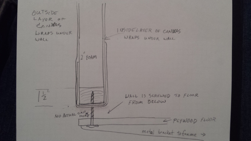

I plan to build a canned ham foamie and since it is tall I am concerned about having a good strong wall to floor connection.
I did a sketch which hopefully I can post and will explain my idea, tell me if you think it would work.
On my trailer the plywood floor extends out past the frame, there are brackets that extend out from the frame. The total floor dimensions will be 78" x 125".
Note that there is a 2" x 1-1/2" piece of wood glued to the bottom of the foam wall that is wrapped with the canvas, I didn't indicate that in the sketch.

I meant to mention that I have read a thread about gluing L flashing to the foam and then to the floor. I'm sorry I don't recall who was doing that. The flashing idea looks good but I cannot find anything at the lumber stores around here that would work well, it's either too thin or has some odd shape to it.
I should mention that on my sketch I would cover the wall/floor joint with some kind of metal strip on the outside, not sure what though.

Postby KCStudly » Sun Jan 17, 2016 1:28 am
That's essentially what I did, except I have a built up floor so used longer deck screws to get up thru; and I'm building off of the trailer so will wrap the side wall skin under the floor. My sills are 2x2 cedar, but 1-1/2 would have been plenty. (I did build this up a little higher in the galley area, adding another 1x on top to give enough for the cooler glide to screw into.)
I would not rely on trim alone to seal the edge of the floor ply. The edge of the ply is the most susceptible to water intrusion, so most people like to wrap that too.
Having the hard edge on the bottom of the wall core really helped to protect the foam during the building process and I'm really glad I did it that way.

Postby GPW » Sun Jan 17, 2016 6:59 am
Actually we found just gluing the foam to the floor works fine , and the reinforcing strip and outer skin hold it firmly to the floor ... But anything extra you feel is needed is perfectly acceptable .. :thumbsup: 8)

Postby Don L. » Sun Jan 17, 2016 9:10 am
Thanks for your comments. As I have heard GPW say before 'do what ever you want to' which I guess is what you have to do since everybody's trailer is different.
KC, thanks, I haven't figured out a great way to protect the plywood edge yet. Maybe wrap it with PMF before the wall goes on top?

Postby KCStudly » Sun Jan 17, 2016 10:09 am
It would be structurally better if you wrap the floor and wall together, or at least add a strip of cloth wrapping them together. Have you thought about building the cabin separately and then placing it on the trailer? You could use temporary boards screwed to the underside of the ply (set back from the edge enough to pre-cover). These temporary boards would stiffen the ply enough to hold everything flat while you are building, yet not get in the way. Then you can use the floor up on saw horses as a work bench to build the walls on.
Building the cabin off of the trailer has many advantages; being able to set your work height to suit the situation; not having to work around the trailer tongue or fenders, etc. I realize that you are planning a larger camper, and it would also depend on your workshop situation, but don't rule it out as an option w/o giving it some thought. Building from the inside out is always better. Even on the big manufactured rigs that's how they do it these days; it's just more efficient.

Postby rowerwet » Sun Jan 17, 2016 4:20 pm
I drove nails up through the floor along the foam to floor join. They mostly just kept the foam pinned in place till the GG set. I did rout the lower edge of the floor with a round over bit to ease the fabric transition from wall to floor.
Once the foamie was assembled, I used a trolley jack to raise it all up on 2x4's, above the frame. This let me wrap the fabric under the floor with no problems.
I can't imagine you need more reinforcement than that. Though you could run a quarter round inside along the floor to wall seam, fully glued to both.

Postby Don L. » Mon Jan 18, 2016 8:59 am
KC, the camper won't be removable. My plan is to attach the floor then attach the pre-made side walls, then the roof. I like you're idea about keeping the edges of the floor (3/4" plywood) flat. That plywood is just floating in between the steel brackets that come off the main frame and the ply won't want to stay flat without some stiffening.
This foamie is sure keeping my brain working! My other issue is the idea of dropping the floor in between the main frame, that way I can lose 3-1/2" from the total height. I would need to cut out one steel cross member in the frame. It's a 1968 Tag-a-long with a 3,000 lb. axle rating. I think the frame is stout enough to handle it. I guess that's another thread!

Postby KCStudly » Mon Jan 18, 2016 9:51 am
Your wall should stiffen the floor just fine once installed, especially if you go with the wooden sill. The suggestion for the temporary stiffeners was just if you decide to use the floor as a work bench off of the trailer frame.
