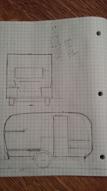

Here's my basic plan, it will be 90" tall, walls themselves will be 84" +/-

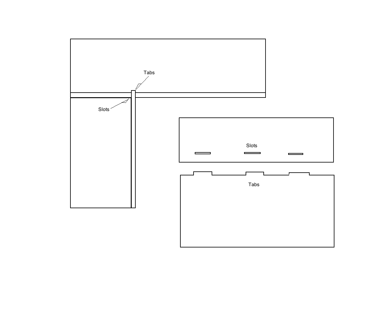

Just thinking , if you’re going to join ply to ply on the inside , what about a tab and slot setup to interlock the pieces together... just a little overlap and the foam and allowing easy alignment... Do we need a drawing ... :thinking:
Re: Canvas outside and 1/4" ply inside?
Postby GPW » Tue Jan 19, 2016 8:35 am
OK.. I think this would work great ... Strong , light , not to fiddly to cut out ... :roll:

Oops, my walls are 74" not 84" high.
Good ideas, thanks so much. I like the tabs idea! My time is really limited so I want to avoid any stick building. The walls and ceiling will be 2" foam and with some internal cabinet/bulkheads (not sure if that is the right term) attached to the floor firmly I'm counting on that to help with keeping things stout, at least on the middle of the length of the trailer. Maybe at the ends inside I could glue 1/4" ply to the walls to give it some racking strength.
