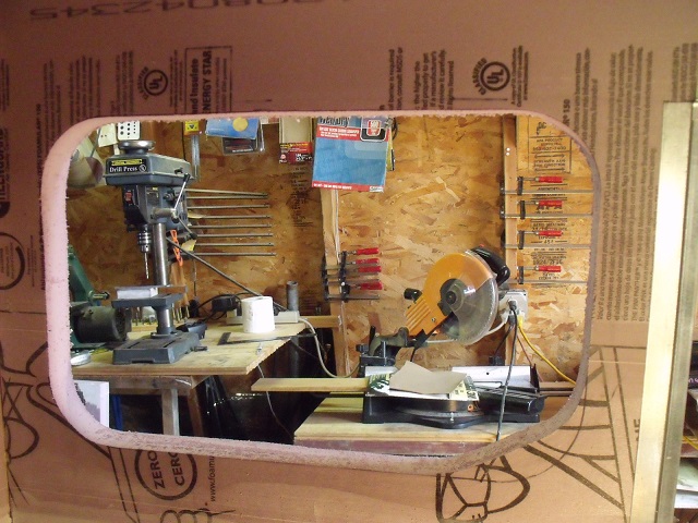

Postby ghcoe » Thu Jan 21, 2016 7:04 pm
I am installing windows with no wood. You would have to do some serious torqueing on the inside ring screws to get the foam to compress. In fact I would think the screw would strip long before you could compress the foam.
Window opening
DSCF3305 s.jpg (161.68 KiB) Viewed 1198 times
George.
