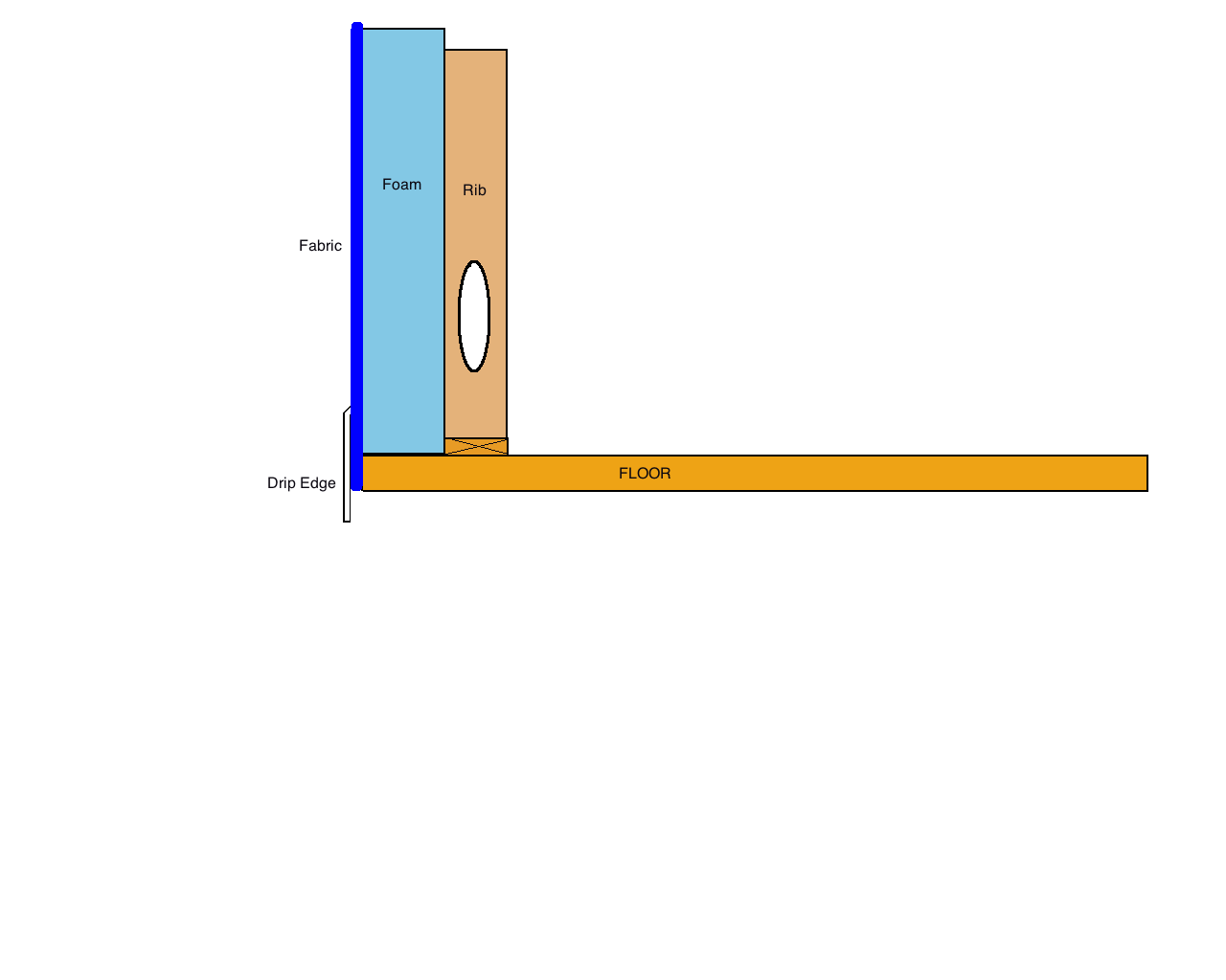

Don, we had to resort to a temporary drip edge just to get our underneath dry ... It rains all the time here so is a Big problem ... It really works , the bottom of the FoamStream in the nose is dry as toast ... Just waiting on some warmer weather to do some new undercoating and install a more permanent drip edge all around ... It really doesn’t have to be much , just a bit lower than the wall/bottom edge ...
Here’s a drawing I made for mine ... note I no longer have to wrap the fabric under the floor because the upper ribs support the foam to the floor ... That way the whole floor can be better undercoated and remain problem free... Any rain or condensation just falls down to the lowest point( drip edge) and falls harmlessly on the ground , not wicking under the floor as before... keeping that area soaked ... :roll:

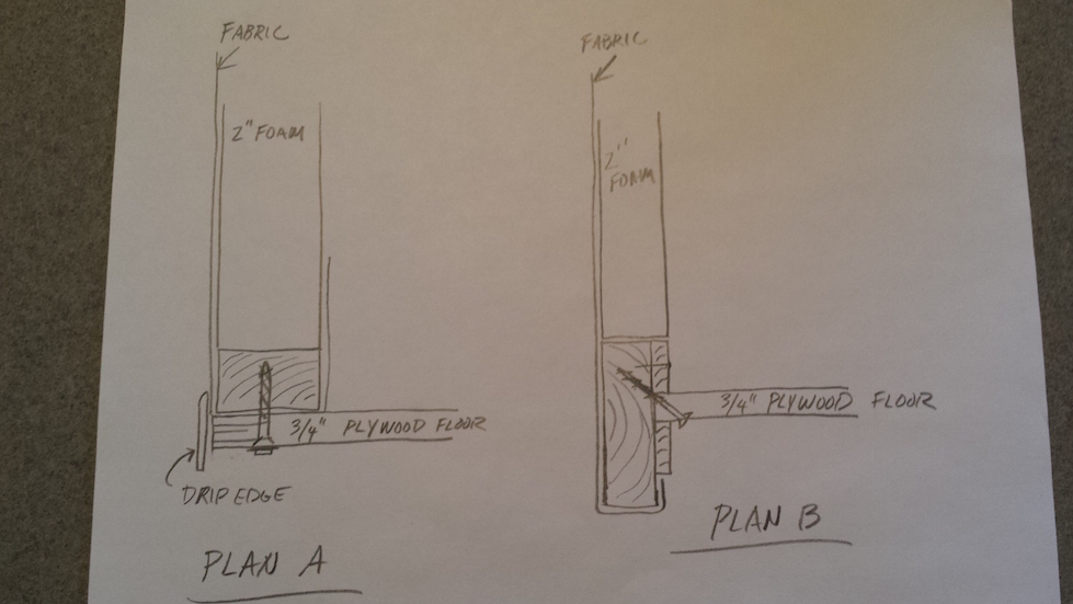

Thanks for the detailed descriptions, that really helps. I can see how a drip edge would help a lot. If you are interested I can do a pencil sketch of what my plan at this point.

Here’s an idea , instead of a separate drip edge ,why not just build and attach the sides down past the floor a little ... :thinking:
EDIT: Oops !!! Another drawing ...

You're right I could easily dream up something fancy, how about curly maple paneling with inlaid purfling for pin striping? :) I seriously have very little time to build my camper even with foam. It is going to be more of a canned ham standy so it has to be light but strong.

Thanks for the ideas for the drip edge. I'll try to get a sketch of what my plan is.
Plan B allows me to install a couple of exterior access doors so the floor will be level with the opening and the door frame has some room to attach itself, also my entry door can be a little lower. Hope that makes sense. Downside is it adds weight, still don't have a great drip edge but that could be added on.

The Big Pink is made like Doc's drawing, the foam extends past the floor.
