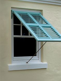

Postby GPW » Thu Mar 10, 2016 1:05 pm
Thanks to all for your participation :thumbsup: ... there are many ways to make a window and I’m also leaning to that “Bermuda “ awning style ... Real simple ... ;)
I think we’d all like to have a moderate sized Vintage Canned Ham ... I know I sure would :D ... I was thinking METAL ... :o :shock: Like a cargo trailer ... sorta’ ..ish’ ... Bent Steel tube frame , Aluminum outer covering , no problem bending the roof around .... Foamie walls inside with decorative fabric glued to the inside walls ... 8) .... :thinking:
