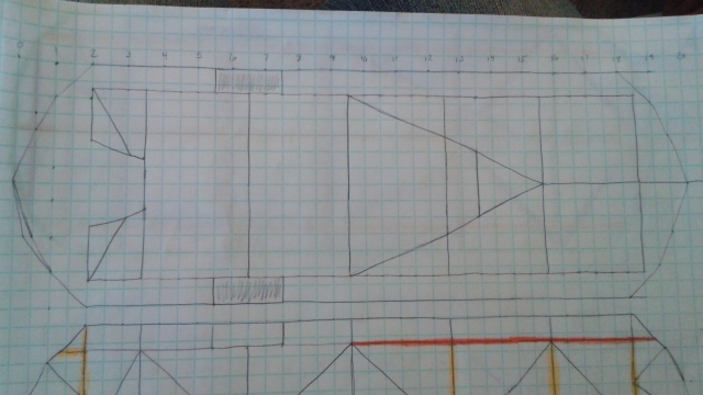

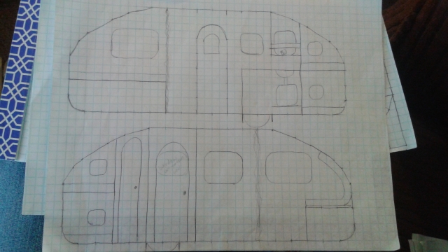

I put it all back together and moved the axle as far forward as the existing frame and holes would allow (about 1ft) to help ballance the weight of what I hope to build on it. I started wiring for the lights.
Just some ideas that I sketched, though the axle has moved since then, the rear section of the frame is 1 ft longer in reality, and after drawing it on the driveway with chalk (as GPW suggested ) it may be bigger than we need. I was afraid that it would be too cramped to fit all the beds, a potty, and a galley. It looks like I could squeeze a table in too :shock: , or just down size to save weight / materials / cost. (I guess I'd better consult the one funding this project before I move forward. :thinking: )

Clearly, I'm no engineer. I'm open to suggestions, and constructive criticism. I was trying to get an idea of how much space we would need, and how we could distribute the weight properly so that the toung doesn't carry too much of the weight.
:D Ideas are welcomed and appreciated.

Postby GPW » Tue Mar 29, 2016 6:00 am
Finch, thanks for the trailer pictures ... The trailer looks Good now ...!!! :thumbsup: But be sure to check the bearings , they’re inexpensive and easily replaced ... Very Important !!!...
Are those all planned windows ??? :o

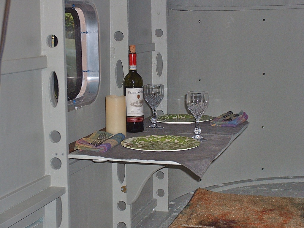

A small fold down table works pretty good and is easy to make ... just an idea ... :thinking:

Bearings are a must. One shop tells me they think they could do it for $85(or more if there are any complications). At that price, I'm thinking that I should do it myself or at least shop around a bit.
Windows are nice, I'd like lots of them. I'm not sure how many we will end up with considering the cost , weight, and structural affect that many windows may have.
I like the fold down table. I'll have to wait to hear if my husband wants to add the luxury of a table, or down size to save $ and weight.
I like the ribs you made for structure, but they sound heavy and labor intensive (without a fancy precision computer guided cutting machine 8) ). I'm looking for a lightweight alturnative that's a bit easier for 1 person to do.
