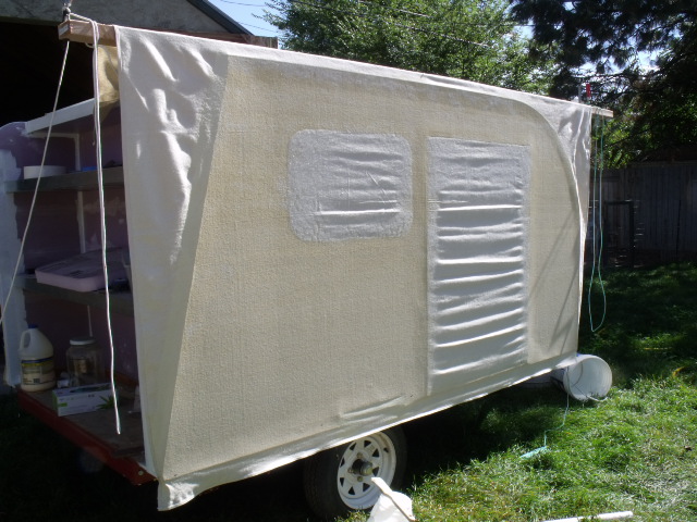

So I think we've ruled out coroplast under canvas. So I'm starting a new thread with the question, what is the best skin to put under canvas?
It's not for structural reasons... we determine a long time ago that structurally, canvas over foam is plenty strong.
It's for aesthetics.
On my mad dash it's very clear to see where the plywood edges end, and the foam begins. It'd be nice to get rid of that, and let the side be one smooth continuous surface.
Is the answer a real thin sheet of plywood? Or is there something better? I certainly don't want to sabotage all the benefits of using foam!
Your thoughts?
