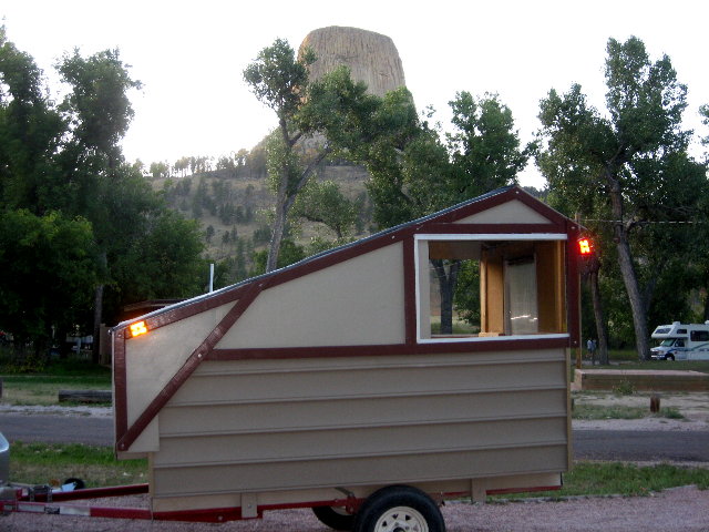

I designed a foamie like the Alto, my thread is on the foamie section somewhere
Can you post a link add/or add pictures to your gallery?
I love the idea of a low profile when towing so less wind drag then when parked you lift up the back and instant standie.
I like your clam shell drawing & design, it is somewhat similar in concept to my Tip Top Tear Drop
http://www.tnttt.com/viewtopic.php?f=5&t=56232
Mine does not have the fancy curves (there are some technical reasons why), but it is built (2x) with over 12K miles of road experience and we love it. I expect to be adding some notes in the near future regarding a foam version of the top tier.
The plan called for 'canvass' sides to fill the gap when it becomes a standie.
I know a lot of people have used fabric sides with a solid state roof, but my preference is for exactly the opposite. Why? -- because I don’t need to fold any wet fabric and worry about exposing the bed to it (or rain during erection and closing). Fabric works just fine for the roof because it is only lowered (not folded and stored) during travel. In fact, travel serves to 'dry the fabric'. The down side is your design must accommodate the vertical height of the upper tier sides.
