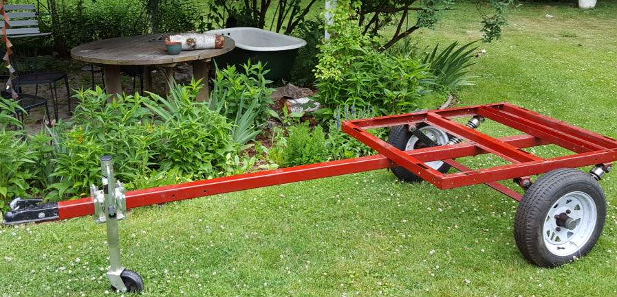

Hello, I finally quit that bad habit that used up my time (the job), and now it's time to wander after I wonder.
When I last posted, i was shopping for ideas, and i had refurbished the chassis of my bodged-up trailer. It was a Kmart kit trailer from about 1985, that I'd modified to carry a sunfish sailboat. Previous estimates are that it will bear about 900 lbs, and so a foamie is planned. i see that the 'state of the art' of foamies has advanced, and so I'll go that route. I have a full arsenal of woodworking tools, with the exception of a chainsaw which would only be necessary if the Frustration/Insanity Index gets above 8.0 on the Richter scale.
I do have a few considerations and questions that I would like to present:
1. Having read various threads that extoll the virtues of a panel made of ply/foam/canvas that results in a composite stressed skin/torsion panel. I think I'll do that. Early experience suggested using 2" EPS, and a recent discussion recommended 1" material. Other than the R-values, is there as significant structural difference?
2. With respect to framing the deck and edges of the walls, many people are concerned with rot, to the extent that a few people have attempted to use no framing at all. When i consider the materials, there's plain old spruce (excellent strength/weight ratio), cedar (much weaker but it has reasonable rot resistance), and pressure-treated (PT). With respect to PT, most people are very concerned with exposure to the chemicals, but i think that the cumulative time of exposure is so low that the risk is negligible. My principal objections to PT are that the wood is green, heavy, and of low quality that is very prone to warpage. So i think I'll use cedar, and make timberframe joints, i.e. bridle tenon joints on the corners, and pegged lap or dado/dovetail for the crossmembers.
3. Everybody seems to like get the deck and sidewalls up as soon as possible, which is understandable. For me, I'll need to build the deck directly on the chassis or build a strongback, and then use the deck as an assembly table for the sides. But before all, I think it would be best to build the doors with frames as a complete assembly, such as would be done in a house. i think perhaps the same should be done for the back hatch, as soon as i decide on the body style.
4. Returning to the subject of preventing mildew and rot, has anybody ever thought of heating the cabin when the trailer is not in use? With a foamie, i would expect that an incandescent lightbulb of 60-75 watts could raise the inside cabin temperature enough to reduce the relative humidity (RH) to prevent mildew. if the trailer were covered with a tarp, a couple of bulbs might just reduce the RH enough to retard rot also.
(I've advised the Lady Wife that installation of a cast iron tub is 'iffy', for now.)
40"x48" platform, ~9.5' LOA
IMG_20160614_095102 (1).jpg (150.39 KiB) Viewed 3577 times

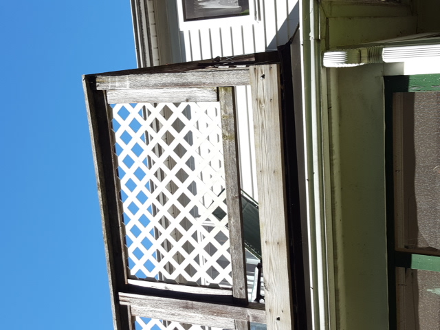

untreated cedar deck after 24yr exposure, on PT sleepers
