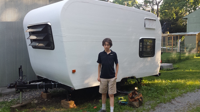

Hi,
My foamie is 12' long on a 14' frame (hitch to bumper), 76" wide and the walls are about 75" high. It has a dropped floor so I can stand up in it.
Link to my foamie camper build viewtopic.php?f=55&t=67321

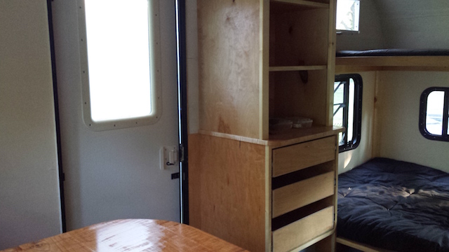

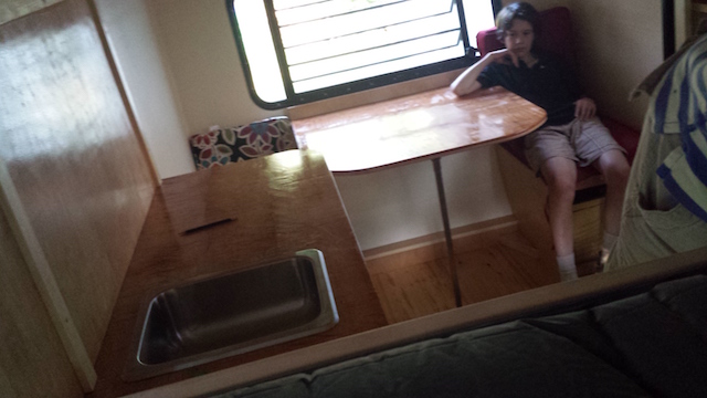

Postby Don L. » Thu Jul 21, 2016 6:34 am
Goes without saying but I should say it anyway, it is on a 1968 tag a long frame which is heavy compared to the HF ones.
The design is tall and wide for a foamie so I made the floor and lower cabinets with 3/4" plywood and attached them very well. Any thing higher up inside like shelves and small cabinets are lightweight 1/4" plywood to keep the overall center of gravity low.
It tows well and is very comfy!

Postby Don L. » Thu Jul 21, 2016 9:11 pm
Thanks!
The pics are from a while ago. At this point I have the drawer fronts on and some curtains almost done, and of course the outside is awaiting some kind of a hip paint job.

Don L. wrote:Hi,
I sure like your windows....

Postby Don L. » Fri Jul 22, 2016 5:20 am
They are used rv windows and door. I put an ad on craigslist asking if anyone had some jalousie windows from old campers and got a reply from a guy that had saved the parts from a bunch of rv's. Great price and really lucky they were made to fit 2" thick walls.
The little awning windows by the bunk I had to make because I couldn't find any small jalousie ones.
