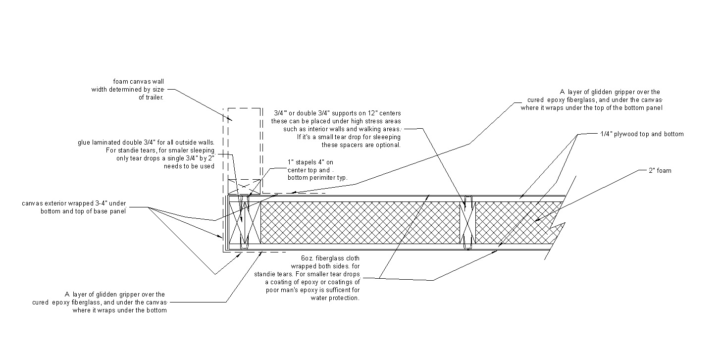

Epoxy and fiberglass mat are the way to build the floor if you want strength,structural flexibility for road travel, lightweight, and waterproof. Wood boats done with this construction have to stand up to the continual pounding of waves and water. For around $150.00 in epoxy and fiberglass mat you can have a strong, waterproof base for a travel tear. The walls and ceiling are perfect for the canvas and foam construction. Those areas do not have the same structural loads. But the base needs a bit more protection and strength. I did a generic drawing of a foamy floor, that may help with a possible floor design. I realize that my idea of the best floor, is subjective.
floor detail.jpg (181.97 KiB) Viewed 2279 times

The best solution is epoxy/fiberglass, but not everybody can, or wishes, to do that.
