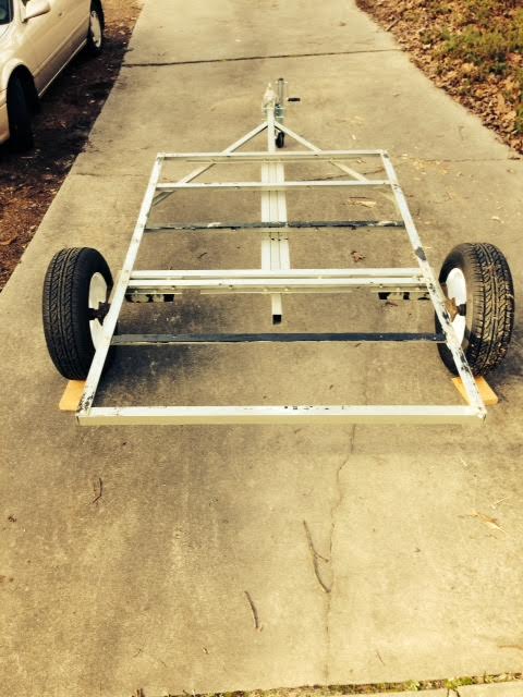

This is the trailer before the extensions.

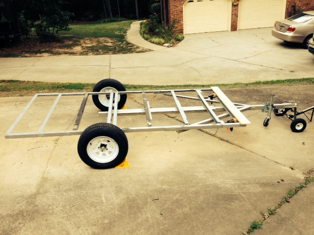

And here it is ready for the TTT.
gallery/image.php?album_id=4369&image_id=142881
The dark color on two of the cross members is transferred evil black goo that was painted on the earlier wooden floor that transferred to the trailer and dripped onto the garage floor during the mid South Carolina summers while it was sitting. I will not be using any of that goo on my TTT.

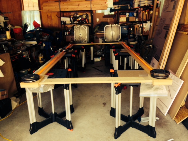

Sub-Floor – (Under Construction)
The perimeter of the sub-floor is being constructed of 1” x 6 in. SYP. It will extend 2” beyond the front and rear of the frame and 1-1/2” beyond the sides of the frame. The cross members will be made of 1 x 4 except for where there is a seam in the foam floor. There, I will use 1 x 6 to provide extra support.
I plan to saturate the sub-floor with “The Mix”, then rough sand it. It will be attached to the trailer using ¼-20 flat head screws at the front (4), rear (4), sides (6 ea.), and on all cross members (2).
gallery/image.php?album_id=4369&image_id=143663
In addition, I plan put a liberal bead of ALEX Plus between the full length of the steel and the sub-floor for additional adhesion.

Postby Alan_H » Sat Jul 23, 2016 1:24 pm
What type of stands are those that your sub-floor is sitting on?

Postby Stargazer » Sat Jul 23, 2016 3:09 pm
The stands are actually folding workbenches from the Orange box store, Husky X-Workhorse Workbench Model# 17185155.
I bought them back when I started working on the Teardrop trailer. ... Gene
