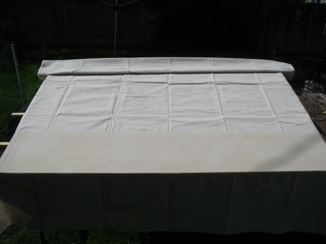

If it is the hospital blanket material that I am thinking of I think it is going to be to stretchy for a good skin. Canvas works beautifully because of is weave and that it shrinks. I know some people prewash their canvas to take some of the shrinking out of it. I found that the shrinking once applied really helps in removing a lot of the wrinkles and again makes a nice tight skin. Here is a picture of the canvas being applied to the hatch. You can see that I just unfolded the canvas from the package and started to apply to the hatch. No prewashing, no ironing needed, 50/50 mix.
Shrinking
I do use a roller to press the canvas down and work out the wrinkles. You can read in my build how I apply the canvas, I have a couple of tutorials of how I do it in there.

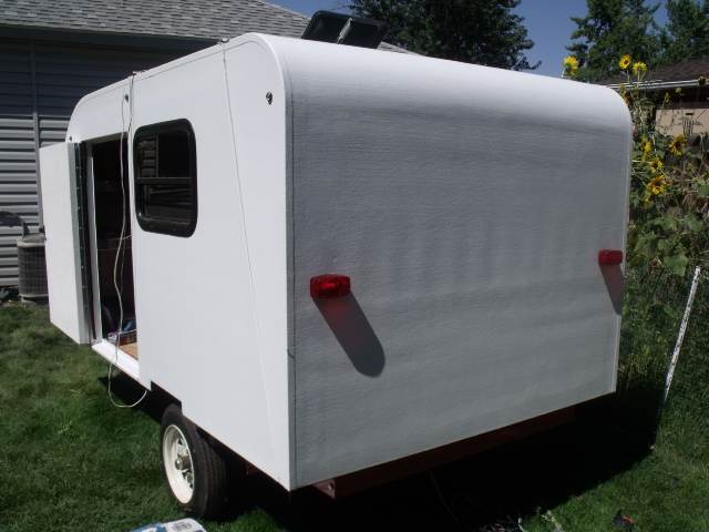

Here is a shot of the same hatch installed and painted at a good angle to see how well the canvas laid down.
Hatch painted
I used Harbor Freight drop cloth canvas for my canvas supplier. The large package http://www.harborfreight.com/9-ft-x-12- ... 69308.html 9'x12' has a seam down the middle, but is enough to cover two 5'+ wide by 9' long pieces. In my case just enough to cover the 8'2' side with shrinkage. It did shrink the most on the long length. The price is good and you can use their 20% off coupon to get it at a better price. Not sure of the weight but I would guess in the 10 to 12oz range. Good luck :thumbsup:
