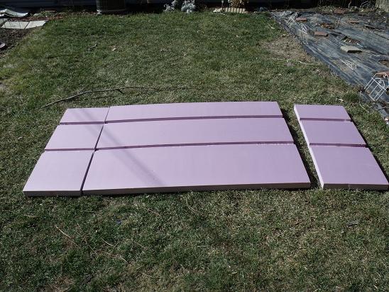

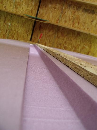

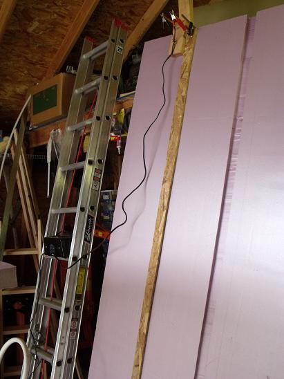

I used the hot wire method.
Groove
DSCF1756 small.jpg (64.04 KiB) Viewed 982 times
Groovy
DSCF1760 small.jpg (100.47 KiB) Viewed 982 times
Grooved
DSCF1759 small.jpg (54.92 KiB) Viewed 982 times
George.

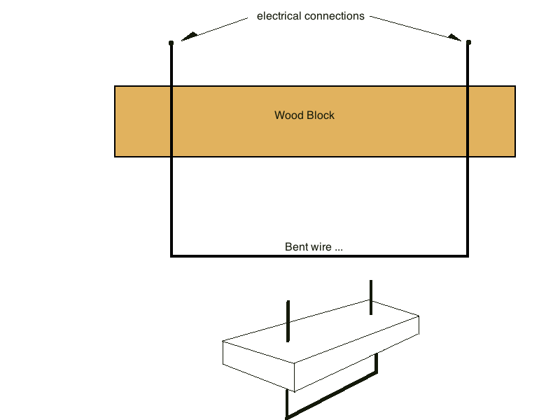

Postby GPW » Tue Dec 06, 2016 6:36 am
QUOTE: “ The trick is doing enough planning to figure out where all of the blocking needs to go. “ ... Sage advice !!! :thumbsup: Plan Ahead ... ;)
Our preference for notching is makng small wires, bent to the shape of the cut and inset into a scrap of wood .... controlled by a Variac , or model train transformer ...
HW channel cutter .png (21.03 KiB) Viewed 865 times
