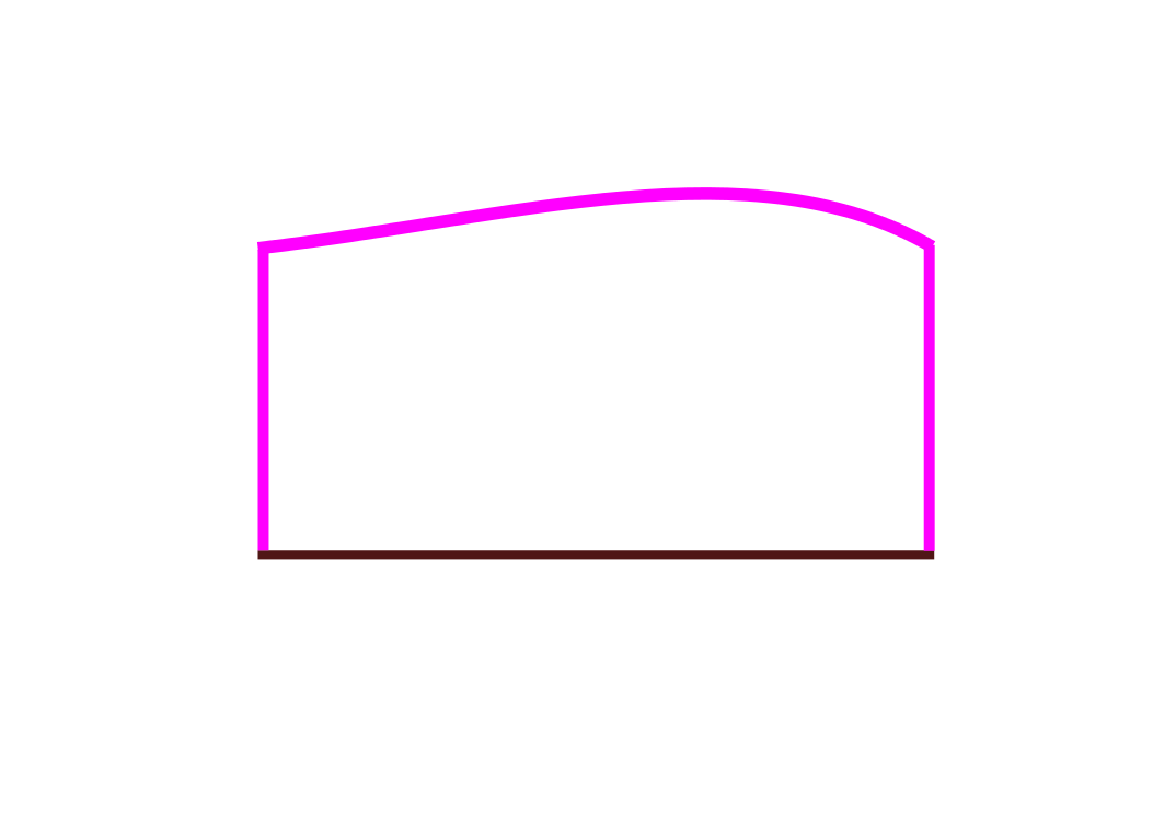

Postby ghcoe » Sat Oct 08, 2016 11:57 am
You might look at something like this. If not too drastic it could be done with 2" without kerfing. With 1" should be easy to do just might need to laminate two together if you want a thicker roof.

Postby Tempest » Sat Oct 08, 2016 12:16 pm
ghcoe, I like that profile better than the ones I've come up with so far. After drawing them out, I realize, I don't like the looks of many angles from the sides to the top. I like the rounded edges or one like you've drawn but I need the head height to be highest close to the middle. Thinking maybe a hybrid foam with using say 3/4" wood arcs. 1/8" luan skin on the inside. Daddo the sides and top flat pieces so the luan over laps a cpl inches, then fill the voids between the wood arcs with GS? Then all you'd have to form is the outside radius of the GS to the outside edge of the wood arcs??????? My design is pretty simple but with wanting a standee and then also wanting the certain items that have to be in the camper, I'm realizing that the camper being asthetically pleasing isn't going to happen.
