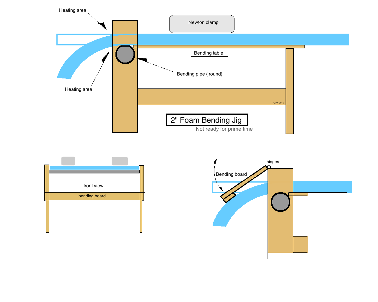

Postby GPW » Tue Oct 11, 2016 7:55 am
We all Love those nice rounded surfaces, but hate the mess and complexity of kerfing cuts to get the foam to bend... Laminating thinner foams together is work , and lots of glue . Plus the fact that kerfing weakens the foam unless the kerfs are close fitting and glued together... and the usual laminating glues might take forever to dry on the inside ... The answer is Heat bending ... easily accomplished with thinner foam , but bending the thicker (up to 2” thick) has been somewhat more difficult to figure out .. So after much thinking about this , we came up with another drawing to possibly show how it can be done ... This is just a table sized variation on our smaller bendFoam jig ( used elsewhere) ... The secret to this is you’re NOT heating the whole sheet at a time , just two narrow areas ( top and bottom ) which bends the foam in stages, You heat and bend a little bit at a time , advancing the foam as more is to be bent ... The pivoting Bending board just keeps the foam even as it's bent ... Heating would be by two people one on top heating the Tension side of the bend , the other underneath heating the compression side ... Narrow heating like this could be easily done with a couple HF cheap heat guns...
A “stop" could even be added to the “bending board" to achieve a uniform bend and repeatability ...
This is just an Idea , but JMHO , I think it could really work well , adding an easy method to get curves into foam sheets ... best thing , once it’s cooled in that shape , it STAYS in that shape ( no springback ) , so is actually stronger... We’ve proven this on thinner foams in the past .
The table sized jig could be make from leftoverwood scraps and just screwed together for disassembly after the job ...
See what you think ... :thinking:
I offer this only as an idea for further development ... Nothing is written in stone... yet ...
Bender... .png (60.08 KiB) Viewed 991 times

The bending jig only requires you heat a thin strip of the foam , and is bent in segments ...much easier than heating a whole sheet ... It works on the thinner foam as we’ve made many airfoiled wings like that ...
It may seem slow and tedious , but I believe it would be the easiest method (cheapest too) for at home ... Couple cheap HF heat guns , some scrap wood , piece of pipe or round closet bar ... Not much of an investment ... :roll:
