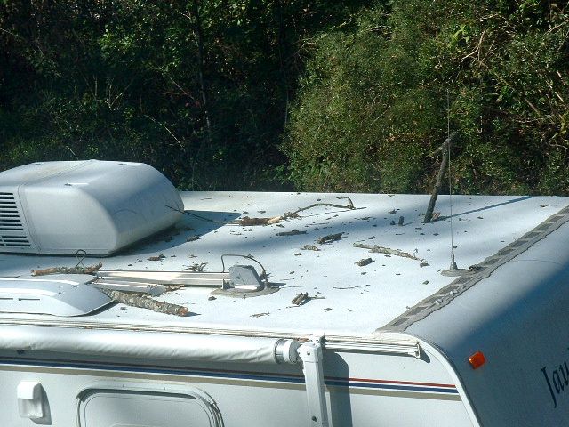

Postby GPW » Thu Oct 20, 2016 6:09 am
We're with Andrew .... hail storms of falling limbs ... We’ve already had a limb go through the roof and into the cab , and that was through a “membrane" ( very thin) 3’32” plywood , and 2” of EPS (beaded) foam , and ceiling paper ... ( commercial RV)
