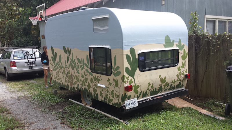

Painting foamie.jpg (241.33 KiB) Viewed 4393 times

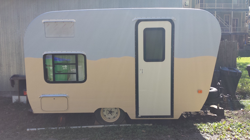

This probably isn't the biggest but I think it is pushing the limits. It is 78" wide x 12' at the longest point, about 10' long where it rests on the chassis. About 90" tall from the ground.
It is almost painted completely. One more side to go, that hasn't stopped us from going camping though.
Link to my foamie camper build viewtopic.php?f=55&t=67321

Re: Largest Foamie ?
Postby Andrew Herrick » Fri Oct 21, 2016 7:16 pm
Don L. wrote:
That is awesome! Is the mural hand painted?

Postby Don L. » Fri Oct 21, 2016 7:28 pm
Yes, my wife is working on the front. There is another picture of it in the thread about 'Paint protection...' that I just started.
Postby tac422 » Fri Oct 21, 2016 10:46 pm
Wow, why haven't I seen this before ?
This is great, and in Virginia too! (we're in Tidewater)

Postby GPW » Sat Oct 22, 2016 5:24 am
Great paint job !!! :thumbsup: 8) :applause: That is a BIG Foamie !!!
Postby WizardOfOdds » Sat Oct 22, 2016 7:37 am

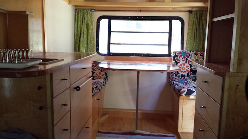

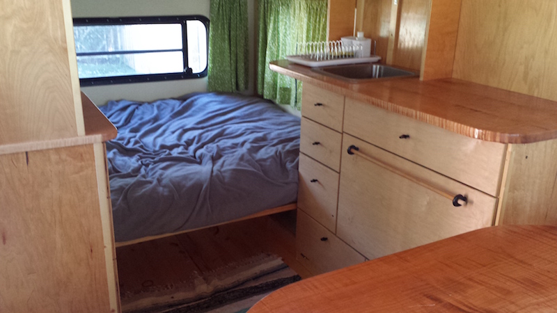

Inside camper.jpg (170.32 KiB) Viewed 4287 times
Inside back of camper.jpg (166.13 KiB) Viewed 4287 times
I was just taking some interior pics so you could see the cabinets inside which were built with idea of structural strength in mind.
I have no other threads going about this by the way.
The lower cabinets and drawers are made with 3/4" plywood and screwed to the 3/4" plywood floor using LOTS of 'L' shaped framing fasteners. Upper cabinets are made of 1/4" plywood wherever possible and 1x facing, with special attention paid to gluing and fastening and making them as strong as possible.
All the cabinet backs were 1/4" plywood screwed into the wall with those metal self drilling anchors (glued in with gorilla glue) and also glued against the wall with adhesive caulk like polyseamseal or such.
Also, I hope the pictures show it, there are wall ledgers here and there to hold up the small upper cabinets and the bunk and also to put pegs into. The pegs see a lot of use from, towels, hats, clothes, you name it.

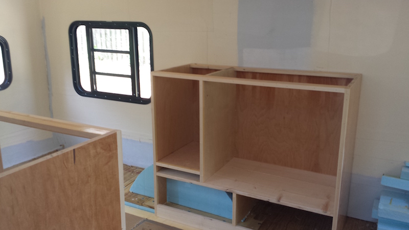

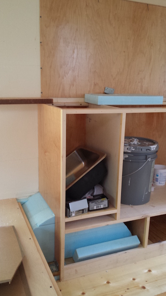

Hopefully this shows how some of it is built. You can barely see the metal connectors where the cabinets meet the floor, I put in as many as would fit, apparently after this photo was taken.
