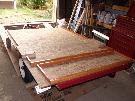

That is what I did with my build. I added 1"x2" alone the walls and bulkhead as well as the back edge of the hatch. Seemed to work great except for my first glue attempt. I used GS and it pushed the walls up. Before I knew what was happening it was too late. Had to wait for the glue to set up and then cut the walls off and glue again. the next time I did not use as much glue.

For my next build I will be using flashing the same way. The flashing will still allow a large wall bonding area but, allow a better wall to floor transition. Then I will add another flashing strip on the exterior along the bottom of the floor and up the outer wall. This will channel the foam and give more glue area. Flashing will be lighter and give nice clean lines to canvas over. :thumbsup:

Your pictures are what I had in mind to do. Make a inner glue point (2x2) around the floor base. And the same 2x2's could also be a point were cabinet structures could be mounted to also.

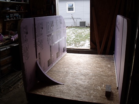

I remembered your post ( or someone's anyhow) about the glue pushing the walls up and decided to use Gorilla Glue instead. The glue still tried to foam up and push the walls around. I used the curved off cuts of the foam from my front to help square my walls vertically (screwed to the floor and later removed) then a ratchet strap (with rope for length) all the way around the wall on the second one (this required help) but kept my wall mated to the floor during gluing.

So is walls moving / pushing around a common problem ? I will be using GG also. And if anyone can post pictures of how you supported your walls to keep them vertical (90*)/square. That information would be very helpful :worship:

I just used the front section that I cut off of the sides, makes a nice right angle.
Support
GS can have a strong hydraulic lift when it foams up so it can cause problems. It also can set up fast, not giving you much time to get things clamped down before it is too late.
GG sets up a lot slower, giving you time to clamp things down.

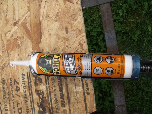

I have found GG adhesive in caulk form. So far with my testing it seems to work quite well with foam and steel. Have not tried foam to wood yet, but I am sure it would work good for that too. It is a bit more expensive, but for some applications I think it would be the best solution, such as walls to floor attachments.

Your wall support looks simple enough. Thanks
