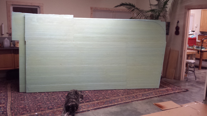

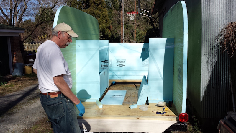

A quick way to glue panels together is position them on a flat floor and tape the joint on one side. Carefully flip it over and prop open the joint and apply the glue. I think I left the panels folded back since the tape n one side its like a hinge.
Anyway, once glue is applied lay down the panel (flat, taped side down) and tape the other side. Packing tape really holds it together, you can move the panels around like it is one piece, stand them up, whatever. I left mine flat and discovered it is best to put some clear plastic underneath the glue joints mostly so the glue doesn't ooze out and stick it to the floor.
My standee is 6'2" inside, horizontal joints like you are planning, and I have not noticed any weakness in the joined parts. You will want some kind of interior stiffening by way of cabinets or ledgers, doorframe or shelves, can be vertical or horizontal. I glued and attached all ledgers, cabinets and backs of cabinets with screw in zinc anchors (glued in w/G-glue). The anchor mostly just pulls things tight until your adhesive sets, I used a lot of adhesive caulking for that.
Walls going up with friend's help.jpg (222.19 KiB) Viewed 1956 times
Wall panels glued together.jpg (154.06 KiB) Viewed 1956 times
