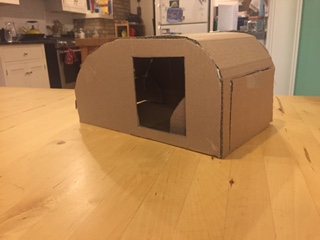

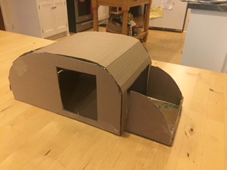

This such a wonderful forum. Thanks everyone. I'm making this post here because I'm likely to build a foamie. If it'd be better to post in the member designs section and just add "probably a foamie" let me know.
I need a little help from the experienced builders/campers here. I like the benroy: pleasing to my eye, practical and plans are readily available. The issue: I have a family - wife and two kids. I've bumbled around the forum and found that people talk a little bit about tip outs as a way to deal with this. So, I need input on the mushrooming benroy.
The idea is two tipouts, front and back, no galley, on a 5X8 benroy. We would sleep with our heads toward the center (two by two). Feet go in the tip outs. Front tip out supported by the trailer frame/tongue. back supported by ???. It know the front tip out blocks the door when folded in, but maybe that is okay?
Please take a look. And don't hold back. If you say "you're better off with a huge pickup truck and a traditional RV" at least I know you're talking to me. TV is a subaru station wagon or a honda CRV, so I'd like light, low and short-ish.
Here is the taped up pizza box:
Thanks in advance!!!
Scott

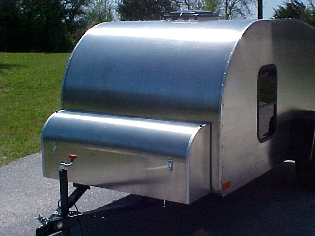

Or, maybe I'd be better off with a 5X10 benroy and a tongue box like this lovely example I found in another user's gallery, except the box would be open to the cabin and it would not need a lid/latch.
The boys' feet would go into the tongue box. The box would be tall enough not to give them claustrophobia and deep enough so the total camper floor length from front to back would be 12' - enough for two pairs of sleepers sleeping with heads toward the middle.
Nothing else in the camper, just a foam floor and four sleeping bags. A step up from a tent and fast setup.

smit0577 wrote:The idea is two tipouts, front and back, no galley, on a 5X8 benroy. We would sleep with our heads toward the center (two by two). Feet go in the tip outs. Front tip out supported by the trailer frame/tongue. back supported by ???. It know the front tip out blocks the door when folded in, but maybe that is okay?
Please take a look. And don't hold back. If you say "you're better off with a huge pickup truck and a traditional RV" at least I know you're talking to me. TV is a subaru station wagon or a honda CRV, so I'd like light, low and short-ish. t[/img]
You could have a galley If you did not have a cabin shelf and with a tip down galley counter it could be used when all set up. A galley is a nice thing about a TD.
The tip out can be very light. No one will be walking on them. It will be just the weight of your feet.
The front Tip-out could be a fold out. One would tip down the floor with the wall hinged to it. The roof hinged to the TD wall and the fold-out wall. Then you would fold out (or install) the side walls. It would make the teardrop use-able when not using the front tip-out (fold-out).
Just my thoughts.

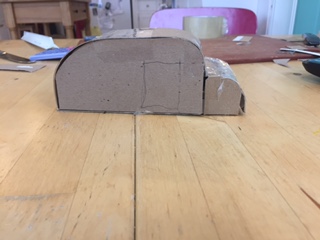

Thanks! I'm thinking a 5X10 benroy would work best for this - I'm a little worried about the extra height (I've only ever towed little boats), but I can cross that bridge later. I hear you both about a galley. Something simple that would not slow down the build would be a great addition. My issue with bunks is - they can only be as long as the width, and I want a pretty narrow camper. Also, the guys are only 6 and 8 right now, but they grow and grow and grow..... I'd hate to regret this in a couple years. Also, with bunks it seems like I'd need some internal framing that might add some weight/complexity to the build?
So, I've thought of a 5X10 with a big tongue (or "toe") box for the front sleepers' feet.
It looks like a ladybug. Is that past the limit of a reasonable tongue box?
