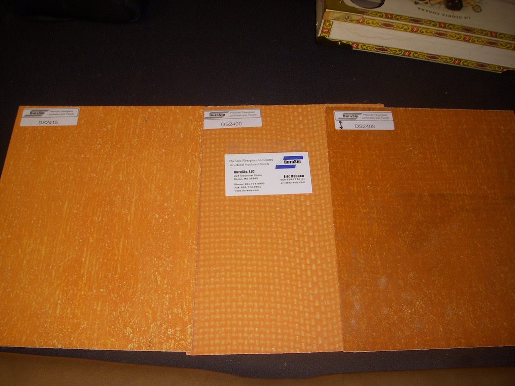

Yesterday , we got to see the material samples , and they seem to be pretty good ... Three thicknesses , the thickest way too heavy unless you're e making a TANK ... The thinnest is a bit on the thin side yet still stiff though ... The middle weight seems to be “just right”...
The price is $1.25 a square foot for the thickest material ... so is “affordable” ...
Curiously the surface has a light texture that would likely be great for gluing , So far as we know Epoxy is the glue , which gives advantage for perforating the foam , and forming “epoxy nails” better securing skin to foam ... ;)
My friend is going ahead with his boat idea , so we’ll follow that as it happens ...

Yes , and that gives those that don’t trust canvas skins with “ puncture resistance “ , a nice alternative ... I’d guess some nice uniform fiberglass tape on the edges ... so easy ... and with a little filling , priming, sandng , I’d guess you could do a really slick paint job ...:thumbsup: ( smooth , no canvas texture ... )
I guess the best thing is that it comes up to 8’ wide so there’s no splicing foolishness to contend with ...
