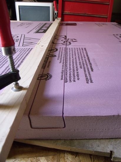

Me I like the hot wire. Nice clean cuts, no dust. Gravity feed is the way to go. :thumbsup:
Cut
DSCF1709 small.jpg (66 KiB) Viewed 825 times
removed
DSCF1710 small.jpg (63.05 KiB) Viewed 825 times

The best way to run a hot wire is just enough heat to cut and use gravity to control the cut speed. Gravity and low heat make a nice clean cut that you see above. If your wire glows it is too hot.

I did away with the pencils. I still use a pencil to wrap the wire around to make a nice wire coil. I found that then I can just bend the wire, once coiled, over and stick the end into the holes I drilled for the pencils. Works great that way. The wire only gets hot between the connectors so you do not have to worry about the coiled wire getting hot in the wood. :thumbsup:
