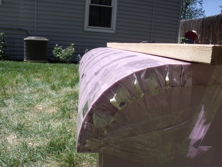

Packing tape works great for gluing. You can get a good deal on it at Harbor Freight. I used it a lot on my build. I would also, clamp some of 2"x4" on each end and in the middle to hold the panels straight while the glue dries.

Packing tape
DSCF1993 small.jpg (184.81 KiB) Viewed 913 times
